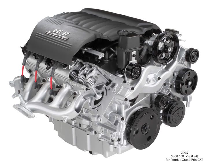

With gas getting so high in certain areas one thing that has been coming to mind was an engine swap. Have a 96 impala ss project and always wanted to do an LS1 or LS2 conversion. With the new SS motor (LS4) with the active fuel management system.... wanted to know if this conversion could be done in the 96 impala. What transmission could bolt up to this engine for a rear wheel application.

Not sure if you could swap the LS4 as it's transversely mounted. If you're going LSX, get an LS2 or LQ9 but don't expect better mileage, just more power.

There are various versions but i'm pretty sure the ls4 won't swap into our cars.

LS4 has a different bolt pattern for the 4T65E. The 4L60E won't bolt up to it. There are numerous other quirks with that swap (intake manifold limits, etc). It would be ALOT more money than it's worth.

the LS4 is for front wheel driven cars only.

The LS4 has the BOP trans bolt pattern which you could get the adapter for from Summit or Jegs. The LS4 comes with the LS6 intake and 243 heads which are good starting points. If you wanted some extra power then a cam swap, headers, and a tune would be beneficial. As for the mpg's of a LS series I can vouch for it being better, my Caprice is averaging between 21-23mpg's with cam, headers, 3:73's and 20's.

LS4s do not come with LS6 intakes. They have their own intake and they are horrible. They do come with the 243 heads though. Those motors are really good for torque. I just got rid of a 2007 Monte Carlo SS and it would spin the tires forever.
