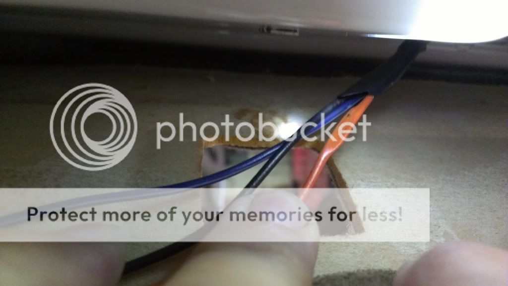

I also had a problem with this fuse blowing and making the gate ajar light come on. After about 4 hours of tracing wires and schematics in the manual I found a smashed wire behind the grab handle LR door.
