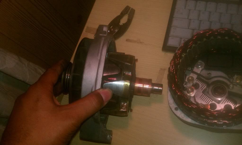

1. take off the 4 screws that hold the alt together(mark the the 2 sides of the alt to kno what way it goes back together.
2. hold the back of the alt and tap up on the top half till it comes apart.
pull straight out on it not to mess anything up
3. take off the 3 screws that are holding the black windings down.
pull out on them so it comes off.

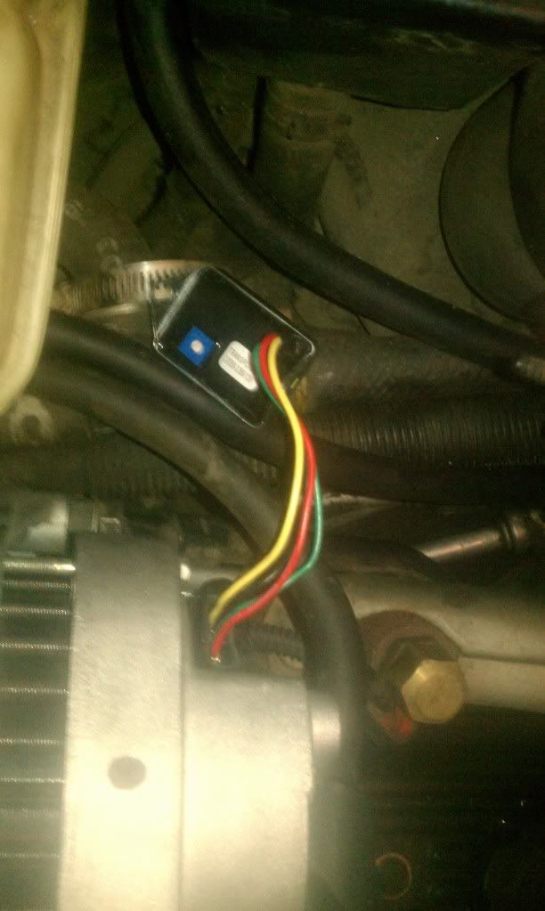

11. install the REAL voltage regulator the small silver and black thing and turn the car on. if you did it right then there is no fire and you see the voltage at 14.67-14.7

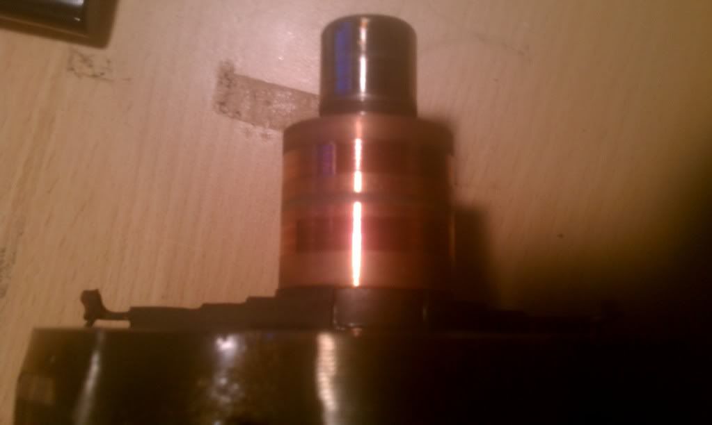

the inside of the alt
CLEAN THIS OFF
UNIT INSTALLED
and if everything was right then....TADA. dont try this charging voltage at home people im a skilled professional and kno what im doing dont put yours over 14.9 JOSH SAYS SO! not responsible for YOU burning your batts

pros: it works and install was easy...for me anyways its small and can screw it down with one of the alt bolts. the screw that changes voltage is small enough to where not just any wrench head with a screw driver can adjust it. it was cheap, came with tracking and was packed well in paper, and 2 boxes so it wasnt going to get damaged in shipping. DID I MENTION IT WAS CHEAP other companes want 100+ shipping for their parts it was only one other one that was around 60 but they are not made anymore i dont think, KAPONE.SS told me about that one (shouts out boyyyyyyyy)
cons: the back stuff on the real regulator seems weak. the wires in it are starting to come out from the corner(ill gorilla glue it later). it gets HOT!(maybe its pulling out because it gets hot) the voltage drops after its been on for a while(i thought it kept it at 14.7 all the time) it drops a lil after it warms up so i had to set it higher so it settles into the voltage i want(i set it already hot) so i knew it wasnt going down any further it could use some cooling fins like some of the other ones to help it stay cool i might try to mount it so the fins on the alt blow air on it. IT GETS HOT! if you dont touch it you wont kno though

Not sure why it gets so hot though?

not sure, it needs fins like ALL of the rest of them. i got vids too. still editing them to look better cuz its hard with no tripod lol

mine was alittle over 200 amps and at 14.7v it never got hot.you could touch it no problem
