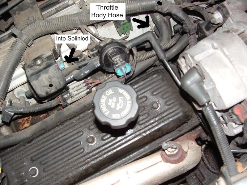

I Need A Vacuum Diagram Of The Passenger Side Of A 96 Impala Ss, Labeling Where The Vaccuum Lines Go From The Passenger Side Of The Top Of The Motor. Thanks

Unlike this pic; on my purge Solenoid valve the top line going out is going to the EVAP canister and the bottom to the throttle body.
According to this my SH!T it backwards.
I know this pic is for a 95 Camaro but shouldn't it be the same for a 96?

Yeah It Is Set Up Like That But The Only Difference Is That I Have A Module Or Something Sticking Out From There And It Has A Rubber Elbow That A Line Is Supposed To Be Going Into.
That goes to the EVAP canister.
Are your lines from the solenoid set up like the photo?

Quote:
Originally Posted by Mean SS View Post
96 has more stuff does it look like this?
is there a Vacuum Diagram on your raidator support ?
http://www.shbox.com/1/component_location_views.html
yeah my drivers side is like this and it has line where this diagram says "vent no hose" and the right side is also different.

yes i am missing a line on the passenger side. the line that goes to the canister is there and it does go to the canister. i have just came in the house from looking at it again. the little thing is a round connector between the line from the intake to the cainster but also on the bottom of the connector thingy there is a rubber elbow needing a line from somewhere. and when i try to start it stalls for about 1-2 seconds.
Ok, then I'm good to go (top line goes into the throttle body and the bottom goes to the solinoid and the solinoid goes to the canister)....and this should be enough for you to get the lines you need and hook them up correctly.
