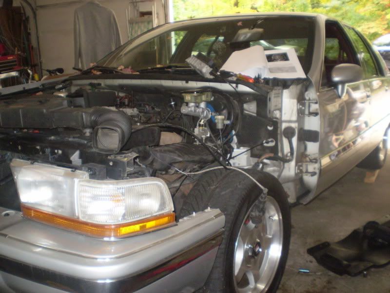

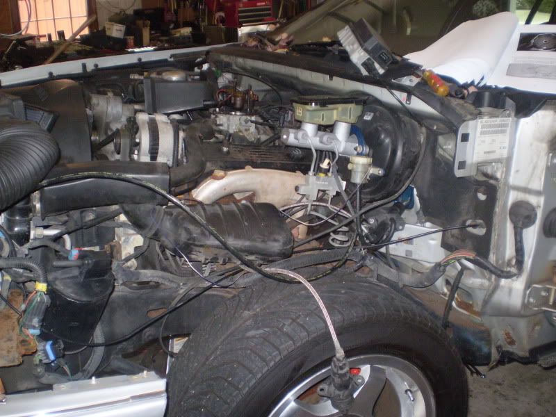

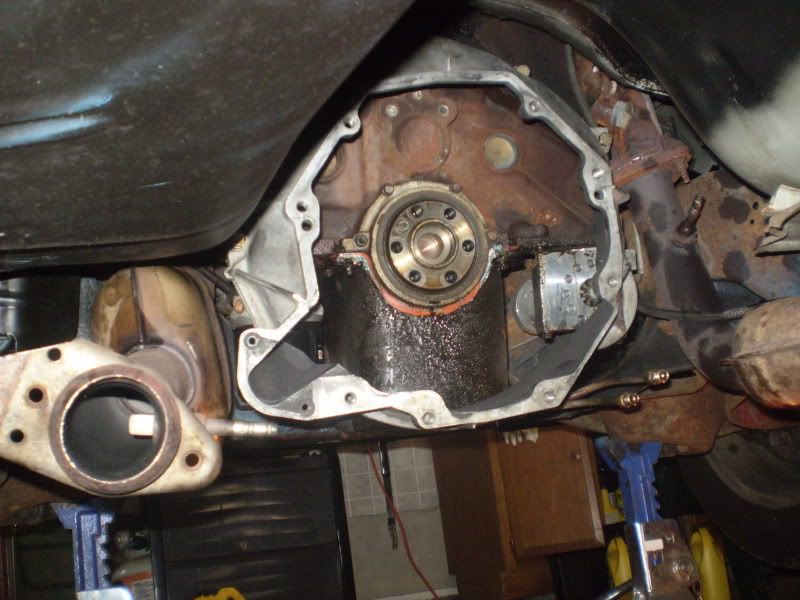

Not quite finished, but it works. Fired it up today and made sure the clutch and everything work. So far so good. Gotta put the interior back together after I do some more work on the trans tunnel, and then put the front fender back on and button things up.

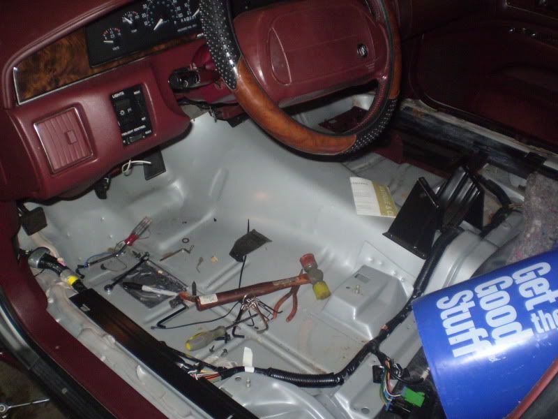

Out with the old

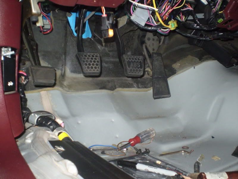

Virgin floors
Three pedals

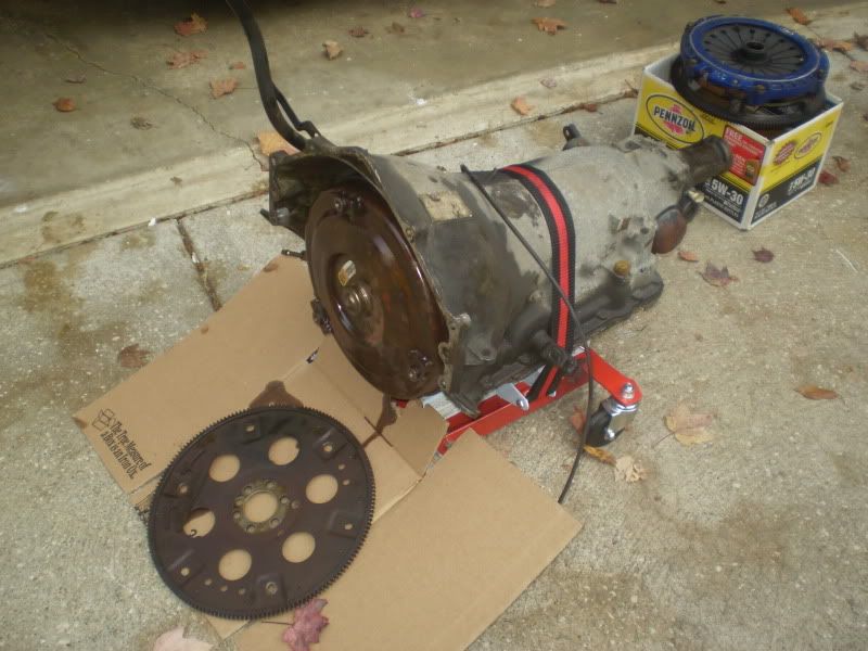

Fitting up the bellhousing and trans. Put in a new rear main while I was in there.

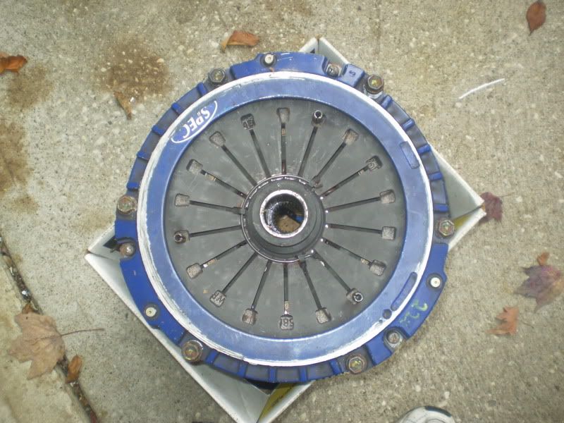

Spec Stage 3 clutch, lightweight billet flywheel
129 Posts
Power Tower by Pro 5.0
129 Posts
Trans is in!
Extended the frame rail slightly
Gotta do a tad bit more work to the tunnel to make it looks pretty and get it up to my specs, but it's getting there!

is there anything done to the engine and since you were down there with the trans and flywheel off did you get a chance to pop out the old rear main seal as in one of the pics it looks like it was weeping pretty badly? would suck to hear that you didnt hope its not to bad of a leak or else be prepared to saturate your clutch disc in worn old oil coming out of the rear main.
good luck
do you have anything done to the engine of your RMS like heads and cam ?
