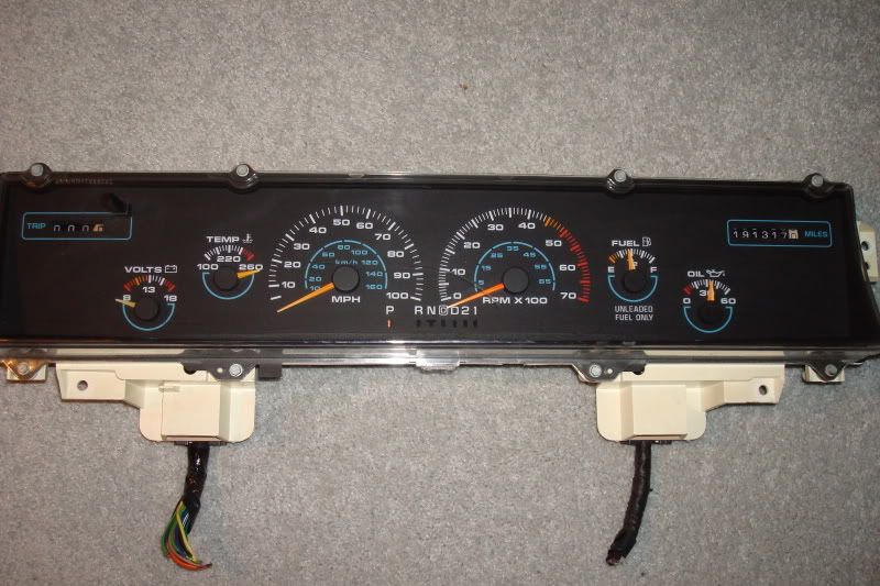

Thats the cluster im trying to switch from to the all analog cluster
the same one I have installed. I didnt want to deal with the chance of the digital taking a **** on me, so I went full analog as well. I really like it.
OOOHHHWWEEE!!!! I cant stand it LOL!!! I want this is my car too, ive had IT FOR YEARS, God I hope he helps me
how did you make the trip miles and all that work with the amount of miles your car really had ?
dam good question, can he change the milage to reflect thats on my car???
I wrote my old mileage down on a piece of paper and stuck it in the glove box.
You can open the cluster up and adjust the mileage to whatever you want though.
can the same be done with the digital cluster, to keep the miles on my car now or am i sh1t out of luck ? if not then that cluster memph1z posted looks pretty damn badass to me lol
