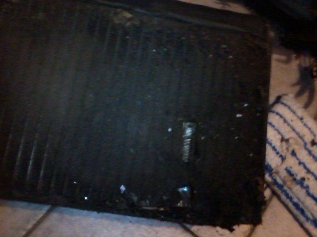

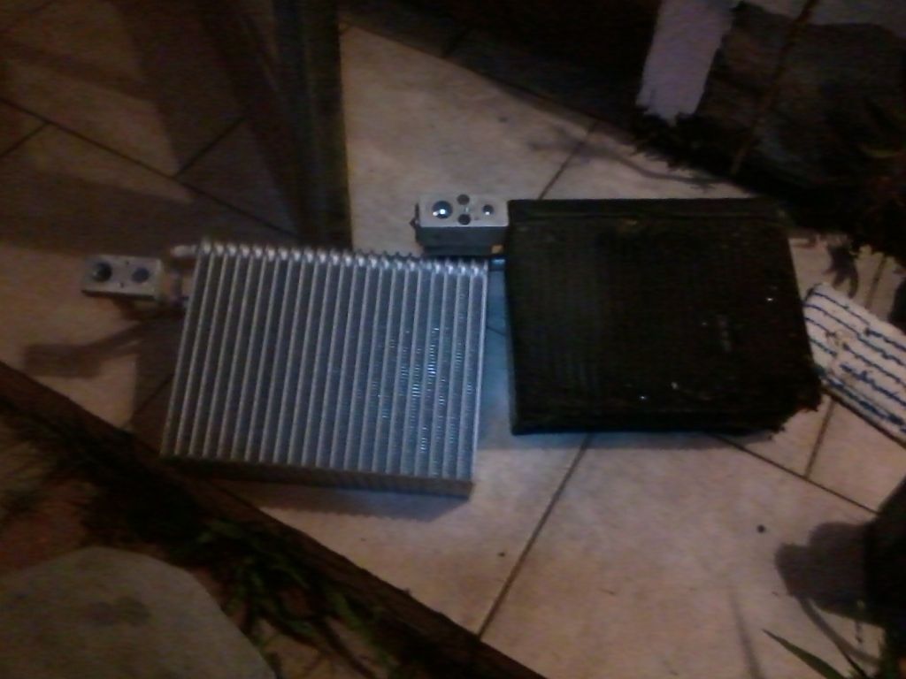

You want to see a dirty evaporator? This was from my Dodge van:
Now that's some repugnant s*** right there.
