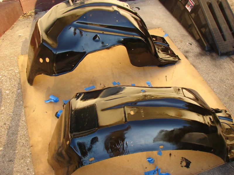

I was just working on mine earlier
Wow, those look nice, great job.
Wow!
New ones? Where did u get'em?
Not new, but no rust holes. Took a grinder with a wire wheel to them. Then POR 15'd, which will get topcoated. The road side will get a mixture of undercoating and sound deadener.
