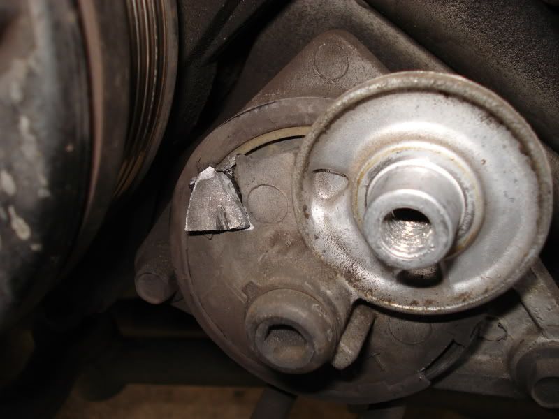

I've had a squeek for a while, and a couple of the Doom brothers told me to change the idler pulley first. It was going fine, and seemed like the easiest maintenance I'd done in a while, but when I started up the car with the new pulley, the noise was worse. I took the belt back off and turned the new pulley by hand, and it was binding. So I take it back off, and this is what I find. Obviously, the old one had been self-clearancing for a while, and the new one was probably hitting it just a little different.
Anyone seen anything like this before? Do I need to change out the entire assembly for the pulley, or can I grind down the piece that is sticking up and hitting the pulley?

I have always replaced the entire assembly. It was only $30-40 and two bolts.
Yeah mine was like that, and it only caused a nosie when the AC was on, and everyone said it was the AC clutch doing it. If only I had changed the tensioner first I would have saved $600 in new AC compressor and install cost. I always replace entire unit.

Well, bit the bullet and changed out the whole thing. That piece that was causing the problem sure is strange. I guess something broke on the inside and popped that little triangle out, hitting the pulley. It's also broken on the back side.
