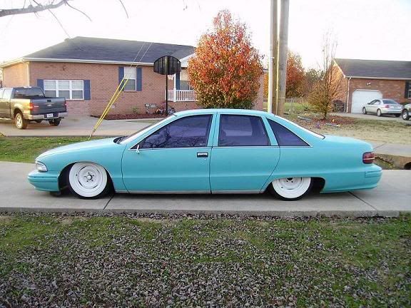

Hey everyone, new guy here figured I'd finally make a post and show some pics of my caprice I've been workin on. These cars are new to me as this is my first one and I've always had mini trucks before but I decided to try something different as I've always thought bagged caprices and impalas look good. I bought the car already bagged for $1,500 off some one on craigslist, brought it to a friend of mine so we could lay it out on some 20's but then seeing rabbit's build, I seen how big of wheels these cars could take so I had to step up my game. Well enough talking and on to the pics.
Front Lift
All Aired Up
We still have a lot of work to do to the car, mainly sheet metal work on the in side and shave a few things on the outside as well. This is a budget build for me so it has taken about 3 months to get it where it is now but thanks to a lot of help from my good friend Ian who knows how to do just about anything crazy to a vehicle it should be done by slamfest in October.

that is sick..i want a skirted caprice now

Son of a [email protected]#ch!!! are you on 4s? so now there will be two caprice's bagged on 4s at slamfest? Good time to step up and get ready for some friendly competiton at the show.:p

Thanks for the comments, Yeah they are 24's. I got them real cheap from a friend but these tires are killing me price wise. I still need to get two more tires, I just put them all on one side to snap some pics.
Rockstar, I'll up load some pics of inside; we did a two link setup to keep the stop back seats, and to get enough lift to untuck the rear wheel mainly so I could change the tire if I got a flat and it not be a pain in the ass.

the 2 link pushed the rear wheels back into the rear of the wheel well huh? it looks good, I have never been a fan of the sedans notched and laying in the rear, they have a tendency to sit up hill, but the wagons look fine laying all the way, weird deal, but good work buddy
