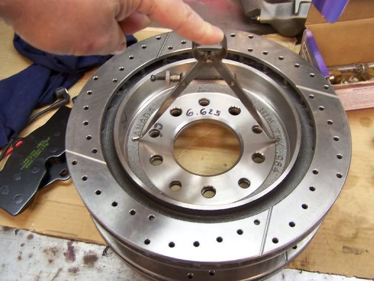

While your rotors are at the machine shop, get the rears clearanced for the larger B-body axle flange.
thanks Dave, I had seen that they were going to need that, so did they just spot face the back of the hat assembly, I hadn't looked at the back of my rotors too closely to see, but that is what I would think.
The C5/C6 rear rotors are cut to mate/fit the 4.75 axle flange. The B-body 5x5 flange is larger in diameter--don't know the difference, but Dave looks to have used 6.625".

1. a DBA 12" C5 rear rotor, which has a completely flat inside surface, no machining was required to clear the larger 5x5 axle flange
2. an OE Z51 C6 rear rotor, before machining out the step to clear the larger flange and fit flush to the flange surface
Thanks Bill, I talked with my CNC guy this morning and I am going to drop off all the rotors to him Wednesday, he is going to open up the center bore to the B Body spec, and machine the back face of the rears and I have the lip similar to the Z51 rotors above.

Make sure the center bore is chamfered on the inside to clear the radius on the axle pilot.
