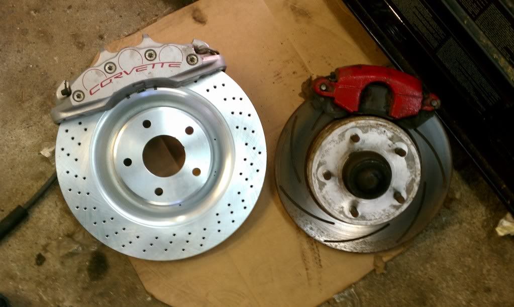

Here is a comparison pic for you, new and old. I would think that the new brakes are going to make a difference. Pic was taken with my phone but I think it came out ok.
Nice.... can't wait to see install pics.
Thanks Bob it is getting there, but it is a what piece to get from whom type game now. I could make my own hubs, but that pushes the track width out to the point were the spacer/adapter for my rims would be too short. I have another idea I am working over in my head right now, but not sure if that one will work.
I will have to get into that a little later, but I am moving right along :)
Great comparison pic,should make a huge difference...you ride is coming along nice! good luck with the brake project,it will be worth the restless garage nights:D
Thanks man, yeah it is coming right along for sure.
