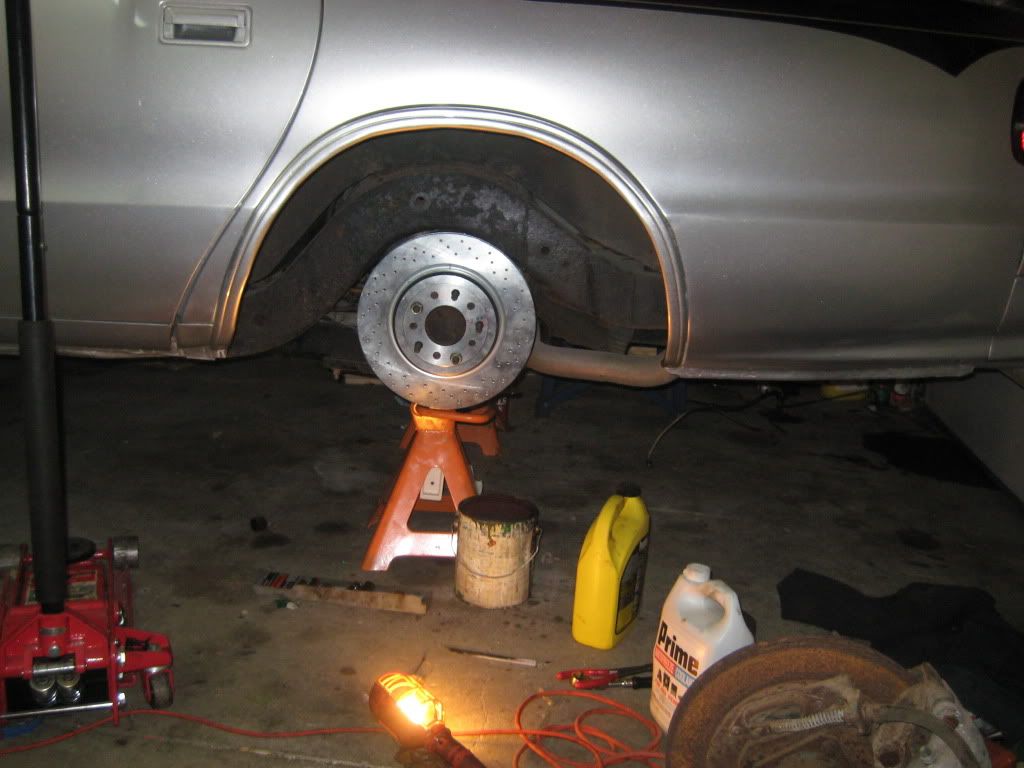

Anyway went out this evening, ok early morning and worked on it a bit, got all the bolt circles drilled for 5 on 5, test fit the rear rotors again and they sit flush I was looking at them odd or something, so 6.5 inches to open up the spot face on the back of the rear rotors is perfect.

Rear rotor mocked in place

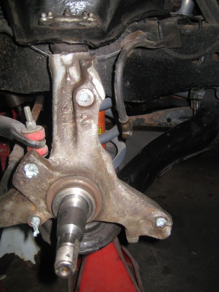

One with the pics, spindles all done with some fresh paint on them, frame to come next before all is said and done.
sanded down and waiting for paint
all painted up
Hubs packed with high speed low drag grease :) well the bearings anyway.
Hubs installed on spindles with brackets as well.
Rotor and caliper temp installed to check fit
