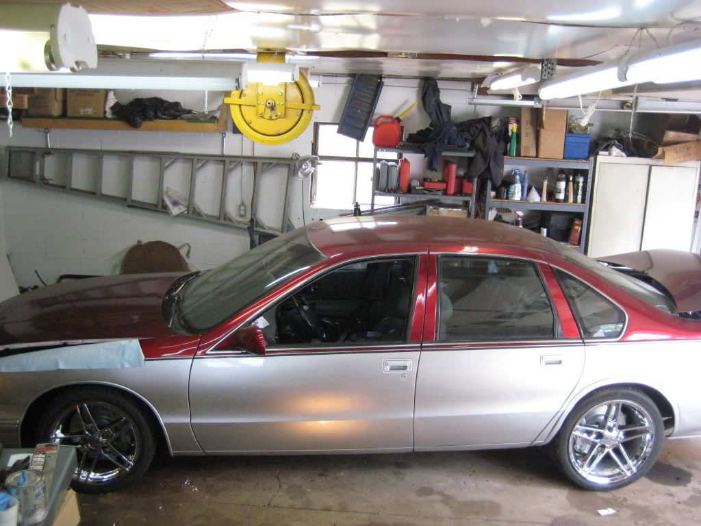

What other pictures would you like to see? Haven't driven the car yet, too much other stuff going on, was going to do more this weekend, but my dad decided to drop into town from South Carolina with no notice LOL. So that is on the back burner. Everything is in though, brakes are bled, may need one more bleed though. Remember I didn't reinvent the wheel on this install by any means, Kore3 built a kit and still does for that matter that you can buy tomorrow. I just did a little development on the rear aspect of the installation, to find another option for the parking brake and two move the calipers to the front of the axle as they are on a vette. :)
Here is a pretty good side shot of the car for you.
