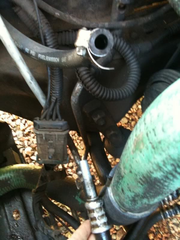

so i got the wrong hardline fitting connection on the radiator for what reason i do not know.... but i can just cheapo my way out of it and bypass the radiator fluid to just go straight to my external cooler on the pass side....
Do you think thats is enough cooling for the trans and will there be flow??

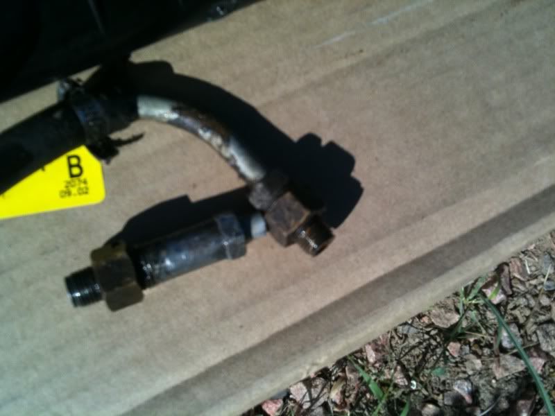

not sure i just dont see how im going to fix it without ordering all the hardlines since someone rigged my **** up ghetto as hell or ran into some type of problem when doing something with the radiator lines and i dont have a piece of the hardline anymore

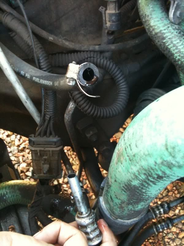

this is the bypass i want to use as u can see a piece of one of my hardlines is gone replaced with gas /fuel line...

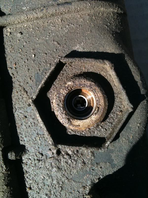

heres my two stock connections that go itno my stock radiator

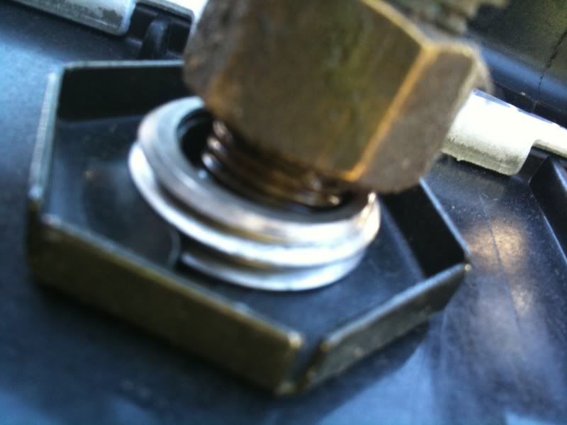

heres a pic of my stock fitting in my new radiator w/o oil cooler, the one with the oil cooler fit perfect idfk
another one
stock radiator
another picture of the bypass id be using

i took off one of the fittings, the other ones soaking in wd 40, im pretty sure thats all i had to do lol i was just to frustrated to see it i think lol, i mean it is my 3rd radiator
