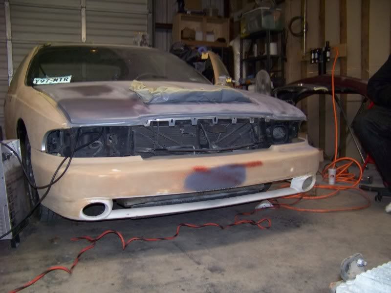

i never understood the whole yellow primer/guide coat. now i see small circle of yellow spot that shows u need to put some putty there. i understand now. it pop up better than the grey one.
u went and saw it today

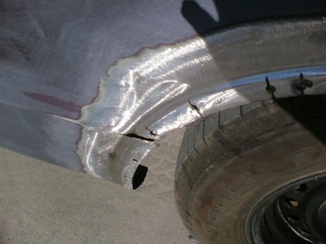

Shaved wheel well moldings FTMFW! Can't wait to see more. :D
I had that front bumper and the stock-sized (non-rollpan) smooth one on the rear. They definitely did not turn out as nice as I'd hoped they would. Looks like yours is (are) being done right! I should've gone looking for someone better, someone into these cars.
thoug
ht my body guy was crazy when he said "tahell with bodyfillers"
3
lookz niiiice! was that done with lead?
i didnt see him do it but from what he told me was he seperated the panel, flatened it out and shrink it and weld it back together. he is supose to be a kick ass metel worker. from what i see, he is
yup that's another way to do, on the one we did I used all metal filler. Much stronger and has metal properties in it unlike plastic fillers
That is one nice lookin wheel arch! I'd give it 3 thumbs up if I could
thanks, he's gonna do a few other things for me too, ill update as it happens

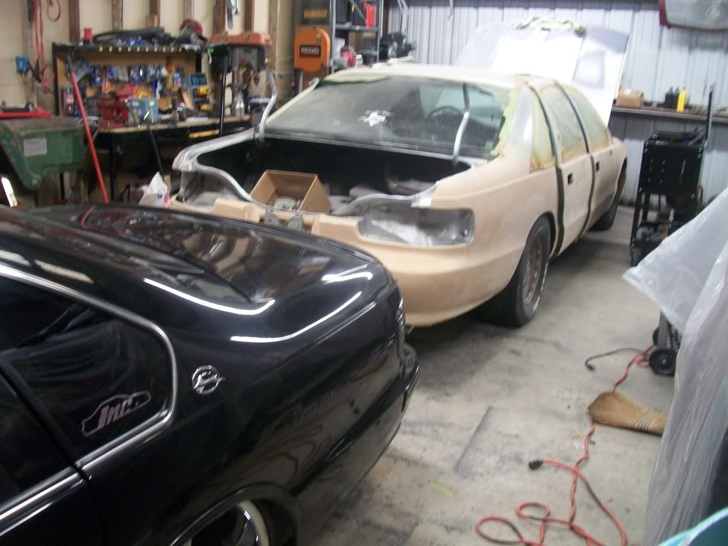

Warren, that motha looking firme!!!! Adam and Voodoo, I see the shop is working, full as hell, that's what I'm talkin about. $$$$
Man it's gonna be nice when we can finally go to shows with 4 or 5 INC rides and post up!! Look out the time is comin!
I can't wait El Mero....I been dreaming about bout putting mines in a car show with you and Adam...
Don't worry, it's right around the corner my Brotha!
