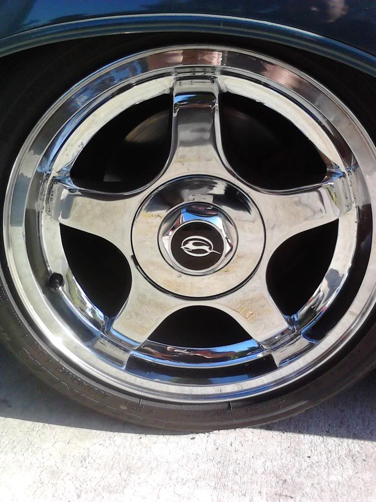

so ill answer..i got some chrome stock wheels with no caps..
i did have regular caps though.. noticed the metal cover over them..
i removed the cover. cleaned the grime off with soap & water..
then polished the staines with chome polish.. took alil elbow grease
but it came out ok.. not a show piece but better than nothing.. you may
have to put tape around the clips so it wont be loose. here are some pics

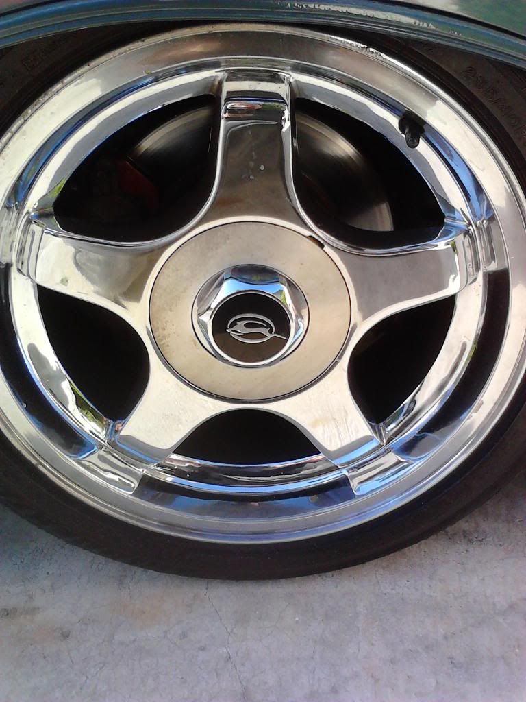

started with this
ended with this

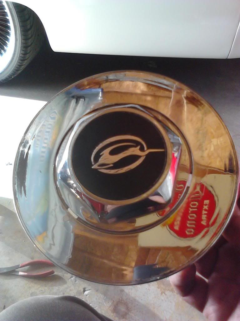

get your cap, turn it over
pry a part of the lip up. the use some pliers to peel the lip back all the way around
then lift the cover off
youll have a dirty grimey surface
wash off with soap n water.. then polish with chrome polish or something none abrasive.. it takes alil elbow grease to get all the stains out
then you can be happy cruzin
hope this helps

i tried your method and used a kitchen sink sponge, the yellow/green kind and scratched my center cap.....pics to follow.
is it possible to buff/sand them out ?
i started with rag and water then went to Mr. clean magic eraser, then nylon scrub brush but the dirt would not come off....cwm3
the green side of sponge was only thing that made a dent.
you think i can fix this by hand or do i need to break out the dremel with buff pad and the "green" compound ???
I don't wanna fubar the other 3...cwm5
-ALF out...
ooh...i think you ruined that one. you must not use anything abrasive.
the caps are chromed plastic. so once the chrome is scratched or worn off
there is no hope. you have to be patient and use non abrasive clothe, cleaner, and polishers..and alot of elbow grease. you may have to find some not so thrashed caps to do.. good luck
