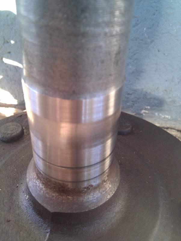

OMG, I didn't realize the whole narrow/wide housing differences. Went to Orielly's and bought 2 Dorman 630-117s because that's what they told me fit in my car. Had the wheel studs pressed in for $35, then realized yeah thats too damn short (and anyone not familiar like me this morning Dorman doesnt make an axle shaft for a 94-96 Impala SS). Now I just looked on Summit and saw the Mosers for $250, I thought those were per side and I wasnt wanting to drop $500 for axle shafts but since i went back and looked it's for a pair, hell I would have done that in a second. Ok so I put in new seals, new bearing and my old axles shaft because I'm sick of seeing my car on jacks. The question is how long do you all think I have on these before I chew up a bearing or the seal leaks again? I'm not running a risk of chewing up the receiving spline in the diff am I? Basically I plan on driving it, and the first noise it makes pulling it all apart again and replacing it with Moser everything, shafts, seals, bearings, and wheel studs. Actually the bearings I removed still looked like they were in good shape. My Dad and his buddy seems to think they'll be good for another 100,000 miles, I think they're both crazy. Anyway, here are a couple pictures, let me know what you guys think...

Top pic - dead
Other - OK for now
Dorman listing is in error
Dead? What does that mean? To me dead means you aren't driving on that PERIOD but I know I can put this back in and drive on it for awhile because it was drivable before I replaced the bearings & seals. It was really just a small cosmetic leak that made me realize there were problems back there and then I had it make a scraping noise when i put it in reverse a couple times but I think that was from being a little low on fluid. Like I said the original bearing is still good and I figured out the whole "incorrect for an SS" thing what I was really asking was what risks am I putting myself at driving on it and how long before it starts to give me problems (what are the problems I'm going to have?) Believe me putting it back in was not what I wanted to do, that's why I dropped $300 at O'Rielly's to get new ones but that was before I realized the whole Dorman thing.
It means I'd park it until it's fixed (replaced), given the choice. That axle shaft is below spec, and the journal surface is damaged--and the bearing can't be far behind. The "cosmetic leak" is the result of the axle shaft running off center with the seal due to the journal wear, compressing the seal at the top and opening a gap at the bottom. It will continue to leak until properly repaired.
If you're running the stock diff cover with magnet--how big was the "fuzzball" on the magnet when you first removed it? The journal will continue to wear and eventually the metal in the lube will pass through all of the bearings in the axle and do even more damage.
I'm not trying to ruin your day.....just want make sure you've considered all of the ramifications of your decision.

Thank you that's what I was trying to understand the ramifications and exactly why. Most people don't care they just want it fixed, I'm a little different. Completely agree though ordering the Mosers from Summit. Fuzz ball was about the size of thimbal. Now that I know it's not moving until the Moses are in
170 Posts
Discussion Starter · #10 ·
Believe it or not the leak was on the one you called good, either way they're both getting replaced. I think they are both bad knowing what I know now.
