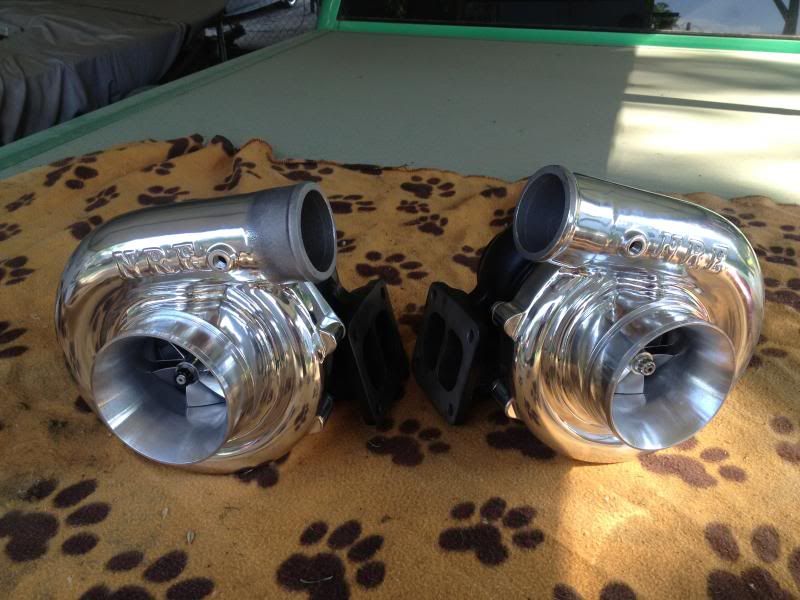

Yes...neslon racing...and Very Expensive...double the price...but...if i do it again...and i am...on my next impala...i will get the mirror image turbos
anyway...do the Turbo pipes look that bad? for not having a mirror image turbo?
Mirror Image Like These?
And Yes Scott, for not having mirror image turbos, your piping looks very nice! I hope to at least match your quality/aesthetics....someday.

Discussion Starter · #87 ·
Mirror Image Turbos
Looks Good Byron...Thanks for good words......cant wait to see what you do with those babies? Ive been following all the great stuff youve been doing with your baby...looking good!!

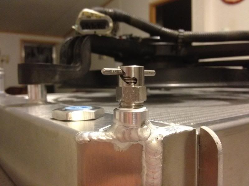

New Updates
Finally got some time to update my Radiator....Everywhere/everyone i looked/asked for best Radiator for our cars...pointed me towards Ron Davis.
I asked for the Latest and Greatest that they have for our Cars....this is what i Got? and a Large Bill!! But well worth it i see!!!
I learned the hard way...do it right the First Time...otherwise it will cost you triple down the Road!!!!

Great looking radiator. Could you give me specific info regarding your fan setup, including the stainless shroud? REALLY nice looking work!
I'm putting in an upgraded radiator and I want to upgrade the fans as well.
Thank you
