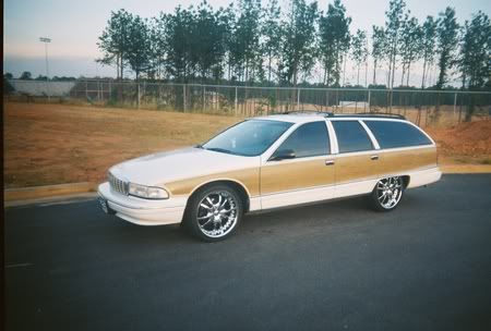

Gentlemen, we can rebuild her. I'll go first:
This was the most radical setup I ever ran. 20x9's on the front, 22x9.5's on the rear. The wheels had a +18 offset, so I used 1/4 spacers front and rear to get them just right. On the front, this gave good turning radius, on the rear, I had about 1/2 inch clearance on both sides. It rubbed my dual exhaust, but a hammer fixed that. Tires were 255/35r20's front and 265/35R22's rear.
