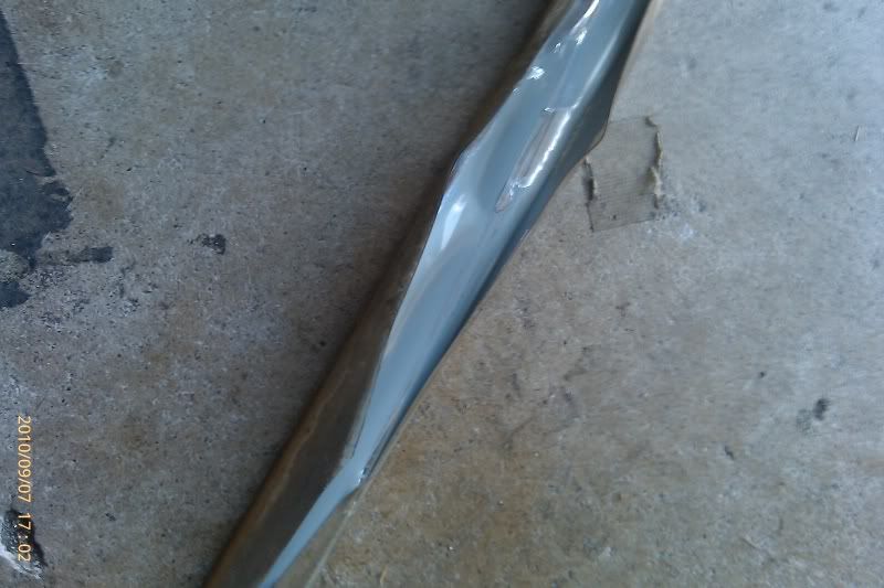

first take off the trim on the bumper
then with a razor blade slice the HARD plastic right down the middle
keep slicing the HARD Plastic and remove it til you see the gray color rubber under
then once you get off all the hard plastic your left with this
so in order to take off all the extra chrome stuff use wetsand 2000 grit with water
keep scrubbing till theres no more chrome left at all
MAKE SURE THE ABOVE STEPS ARE PROPERLY DONE...ITS ALL IN THE PREP WORK...
then spray them...i used krylon fuzion gloss black...(let sit for a day...just to be on the safeside)
then used some double sided molding tape
then applied the molding to the bumper...amazing
EXACTLY LIKE THE SS'S color matched molding...
this was done by me and myself only...so anyone can do it...takes a couple hours

super ez...lol pry one corner up/off and then lift up...
make sure you try to take off the old molding tape so the new one can stick better...use goo gone to take the old tape off

itll splice the strip but since the blade is sooo sharp it will be hardly noticeable...then wetsanding and paint will cover it up...in the end you wont even notice the splice in the actual strip
787 Posts
I did the same but did not remove the hard plstic / cover,, Wet sanded with 400, primed , painted.. Been over 5 years since doing and no problems at all..
