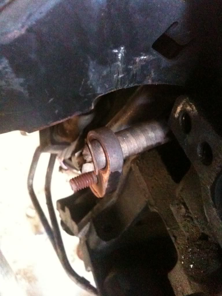

Ok guys, Im in the process of installing my new headers, so far so good. I started with the difficult side, passenger side. Not too bad, all bolts came right off with none of them breaking. I do have one question. What is this hook-up behind the passenger side manifold? Im assuming it's something related to the AIR pump which in that case mine has been deleted.

Thats the EGR Pipe

Thats for your EGR, its connected to the back of your intake manifold. You will need the block off plates if you dont have the EGR hook up on your headers

nope thats the egr pipe that goes to the back of the intake manifold. if its been deleted then it should be programmed out of your computer from what i hear. also heard that it will cause problems if not hooked up but im not completely sure. look it up one of the stickies. let me know how the install goes. i just got my set of gen II last friday and will be putting them on in the next week or so.

So given my 2 options, should I get block-off plates or try and get a header with EGR hook-up? Looking for easy effective route. Thanks for the inputs.

After doing some research, I decided to go with the EGR delete. I need to tune my PCM so might as well get rid of all that unneeded crap. Will be buying the block-off plate soon. Thanks for the inputs. BTW the headers are brand spanking new thanks to the last group purchase.:D
