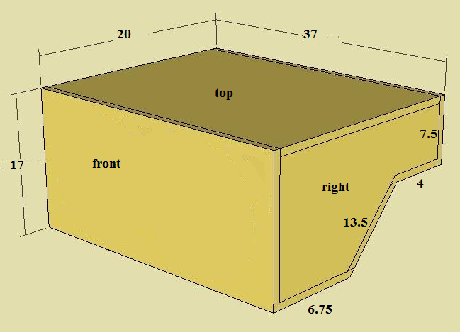

start this out with the sub box. first i was going to keep my old 13w6 in a big ass box taking up my whole trunk. then i figured i'd do a nice box to fit under the rear deck like lots have.... was going to go with the ebay box but decided to build my own to get one with more volume.
box plans and build:
