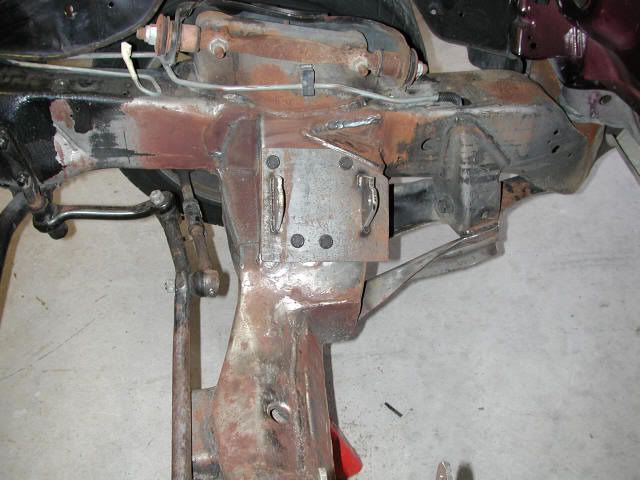

The other things you will notice about this B-Body frame below..
Notch for Oil Pan.. Most likely a Fbody pan was used that was in stock form.
There is also a notch for the headers.. My guess is they used Fbody style long tubes.
The other thing to notice is the support bracket that comes from cross member and goes to the frame has had a portion of it removed , this is also for clearing the headers at the point where the tubes come together at the collector.
You can see the notch just in front of the motor mount.

In the 2 following pics, you can see the motor mount adapter plates.

Added Roger. Thanks for pointing that out. That was what Marcus did for running QTP F-Body headers.
