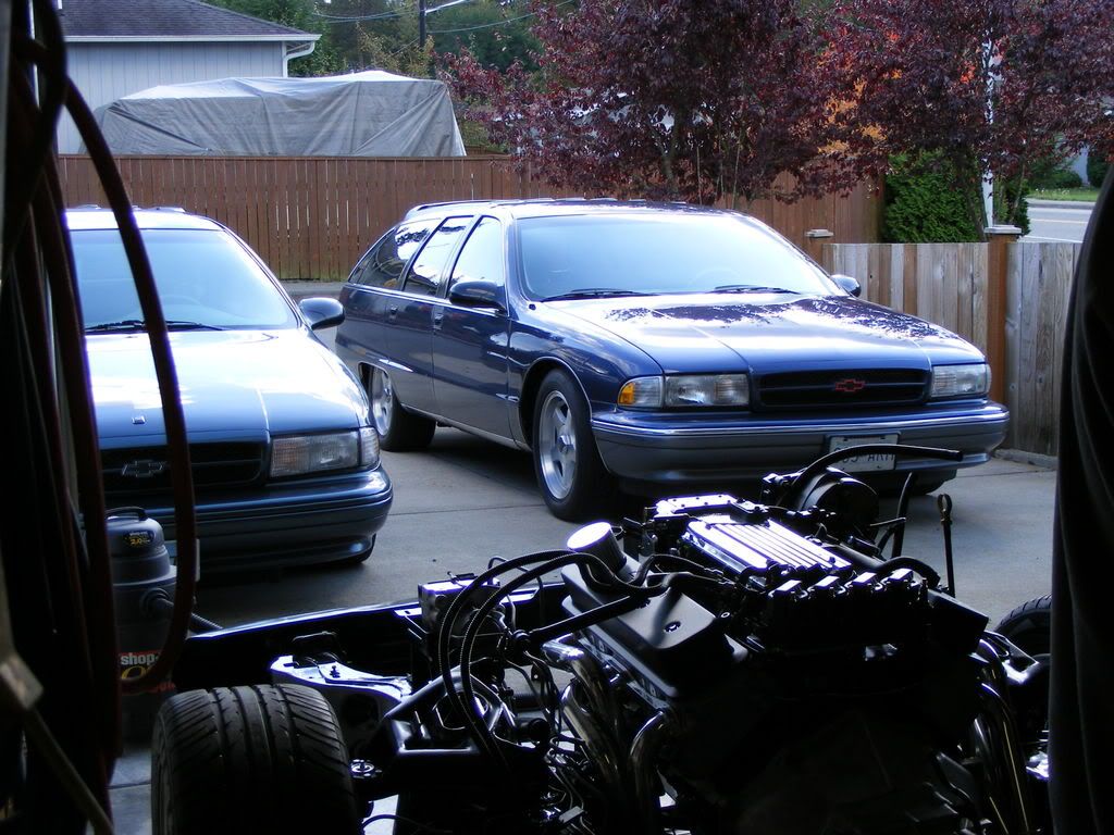

Hey John, that first pic is a cool shot!
Definitely! It's like the other wagons have come over to check on their sick friend who is home from school. "Can Timmy come out and play yet?" "No, he still has a fever." =D
