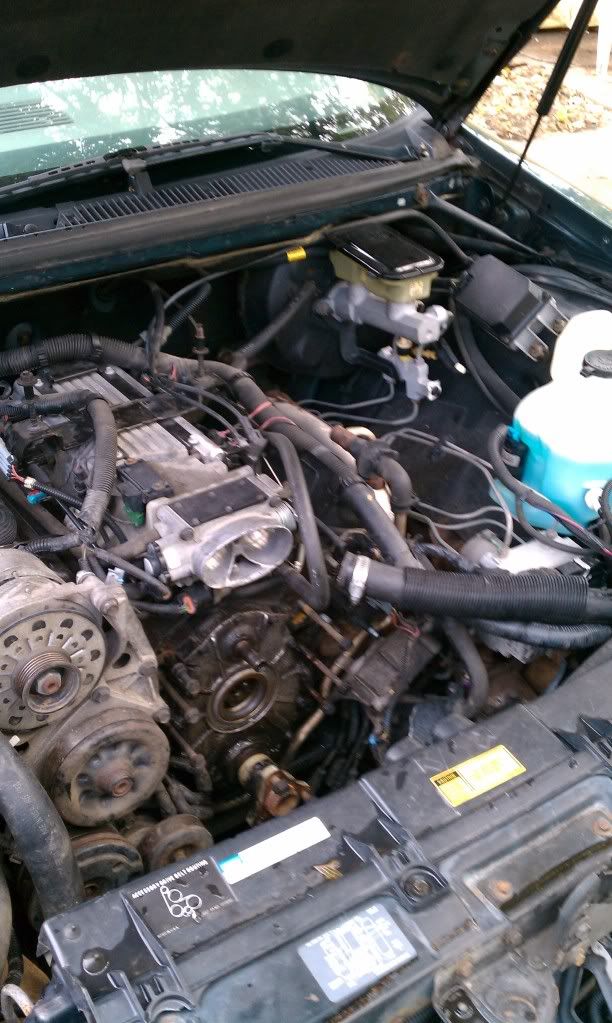

another of the clean engine bay hard to believe this is a salt belt car, looking at the paint or the clear peeling it must of had a bad spry from the factory it has been that way for sometime.
I would say the throttle body is clean enough :)

Just some looking around under the hood I am going to have to yank the radiator out as the lower support is bent and it broke the plastic radiator support on top, easy enough there isn't any coolant in it anyway.

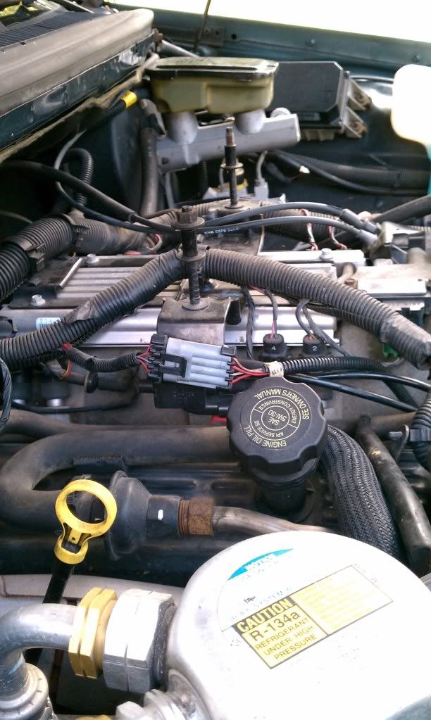

Now here is the opti the kid took off, I will take it apart and see what the insides look like, but it doesn't look old by any means.

We will see I may throw the old Opti on it and see if it fires for a quick second with out the water pump and stuff on to verify, I will at least check the voltages at the opti, could be the optical sensor. Not sure. I just find it wierd that the first problem is it ran and would die after start, which would kindof point to a fuel problem, he troubleshot it and then got it running and then it would run at all, I did email him asking what the symptoms were the second time, like if they were the same as the first or if it wouldn't start at all.
