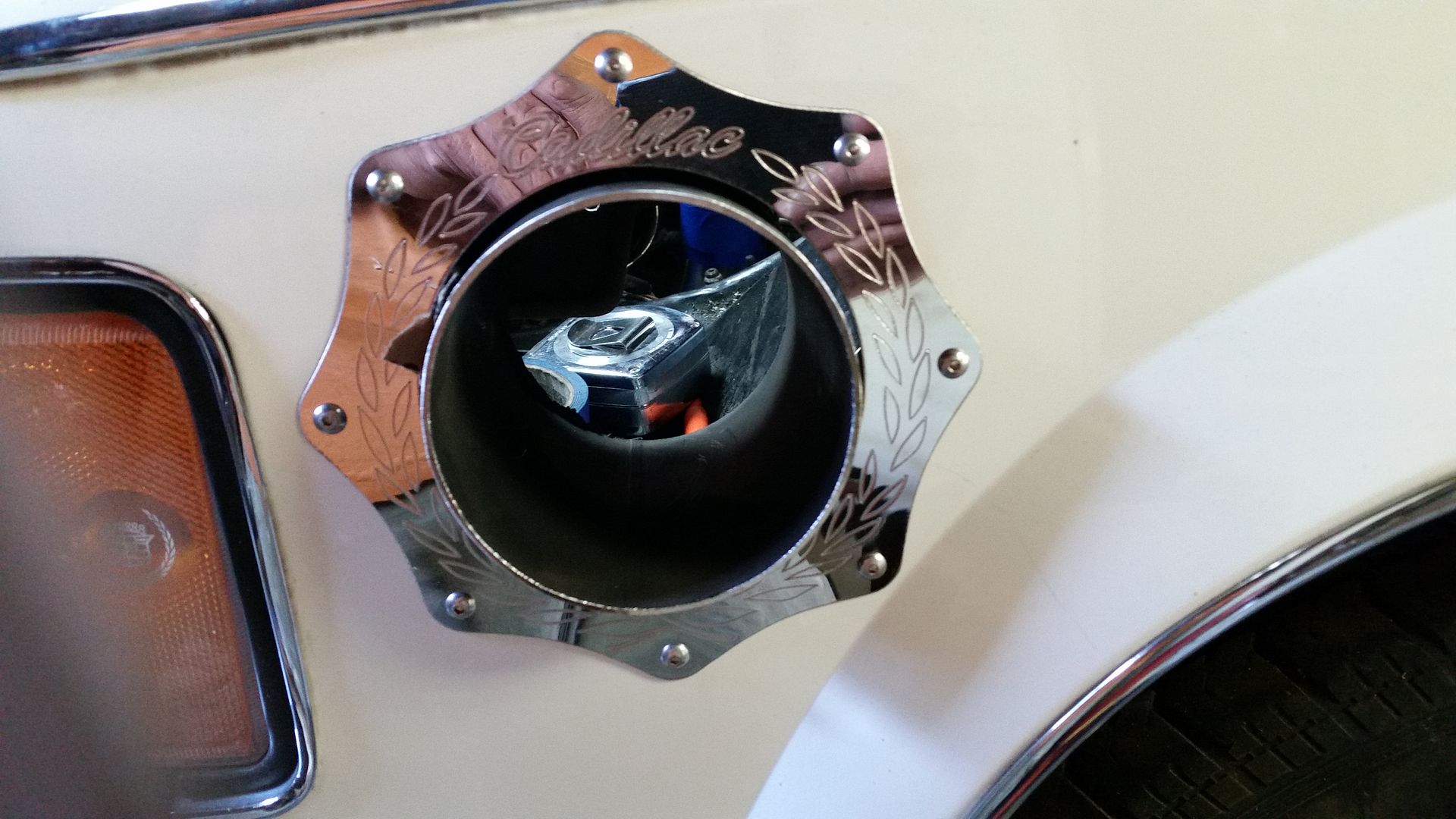

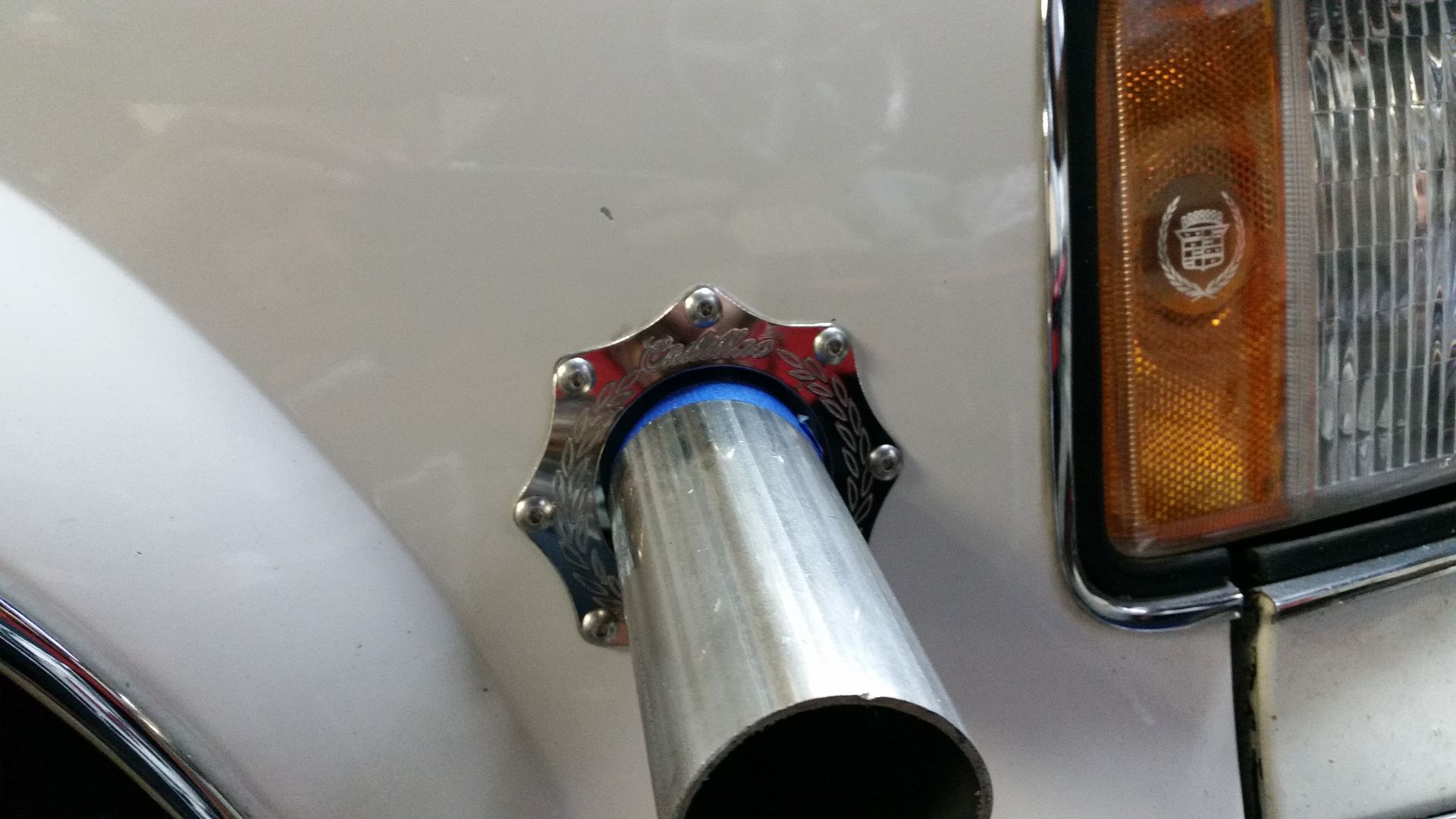

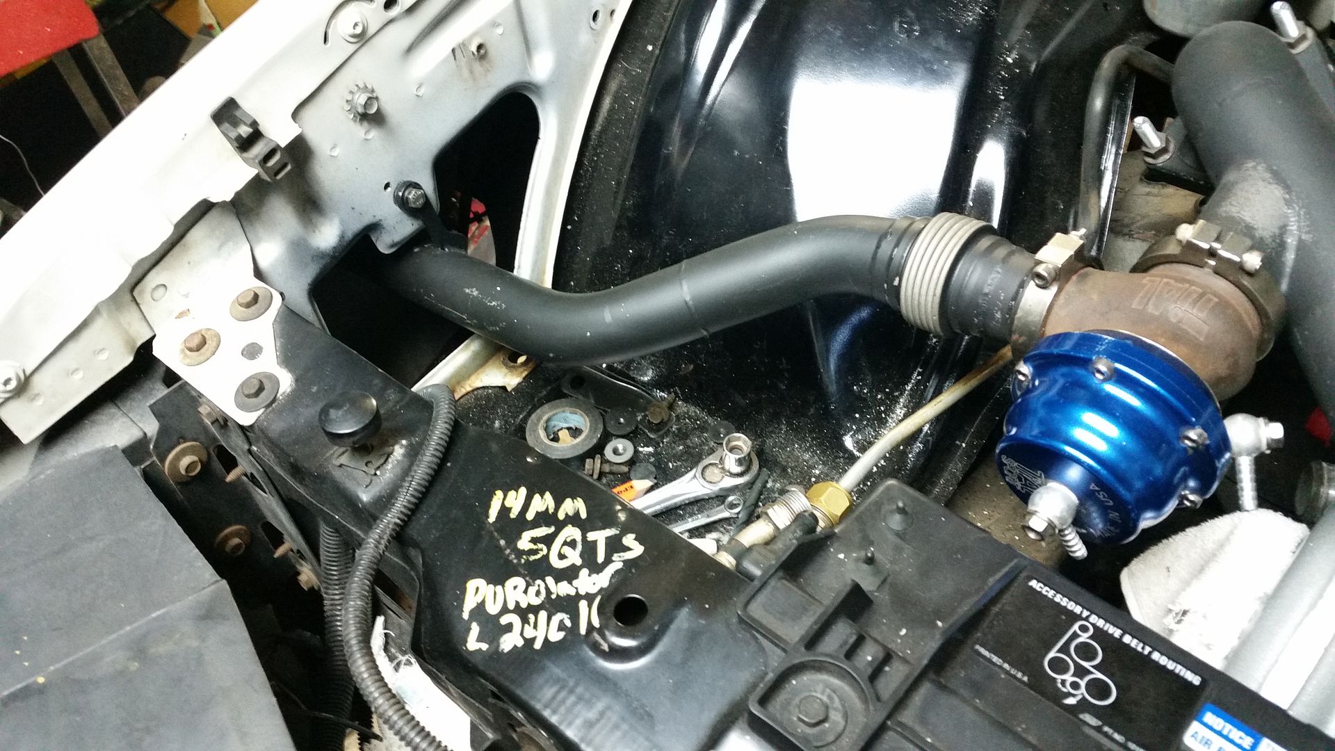

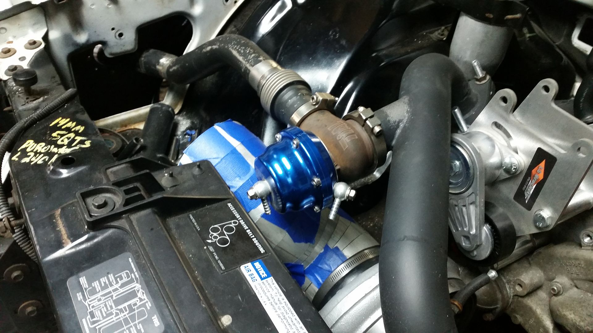

4" exhaust out the fender over 3 psi boost. Otherwise 3" out the back with a muffler
Passenger side wastegate dump. It has been redone to make more room for an air filter.

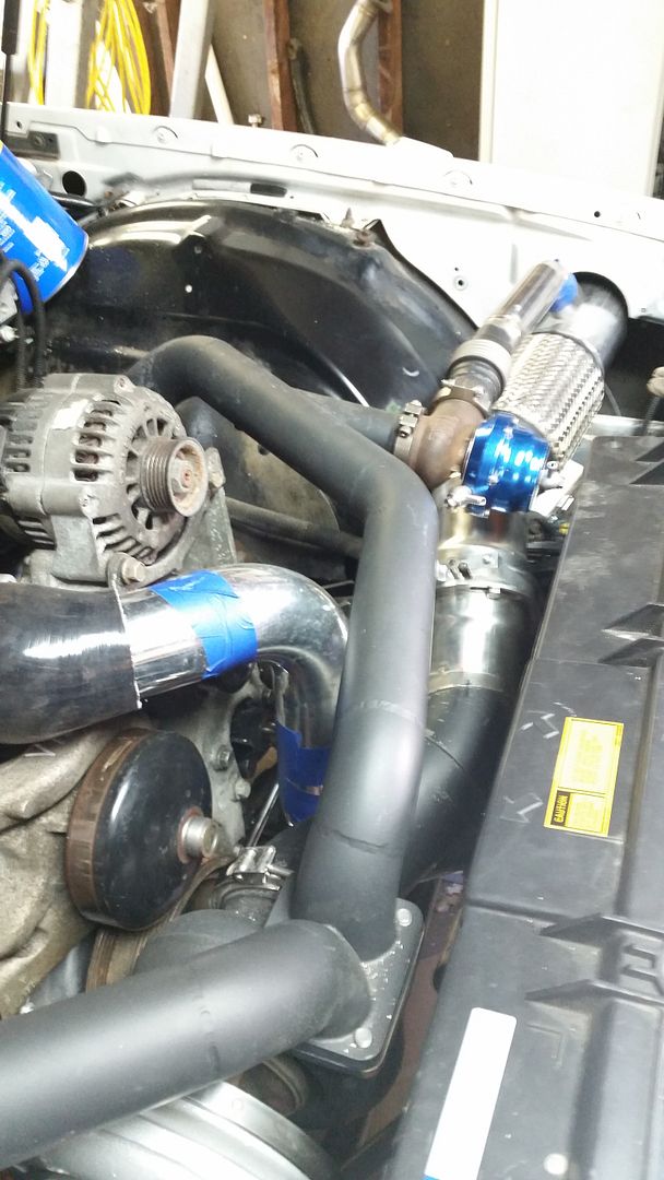

Little more progress.
Redid passenger side wastegate dump to make room for air filter. Got the aluminum intake tube ready for welding.
Cutout will open via wastegate actuator at 3.5 psi

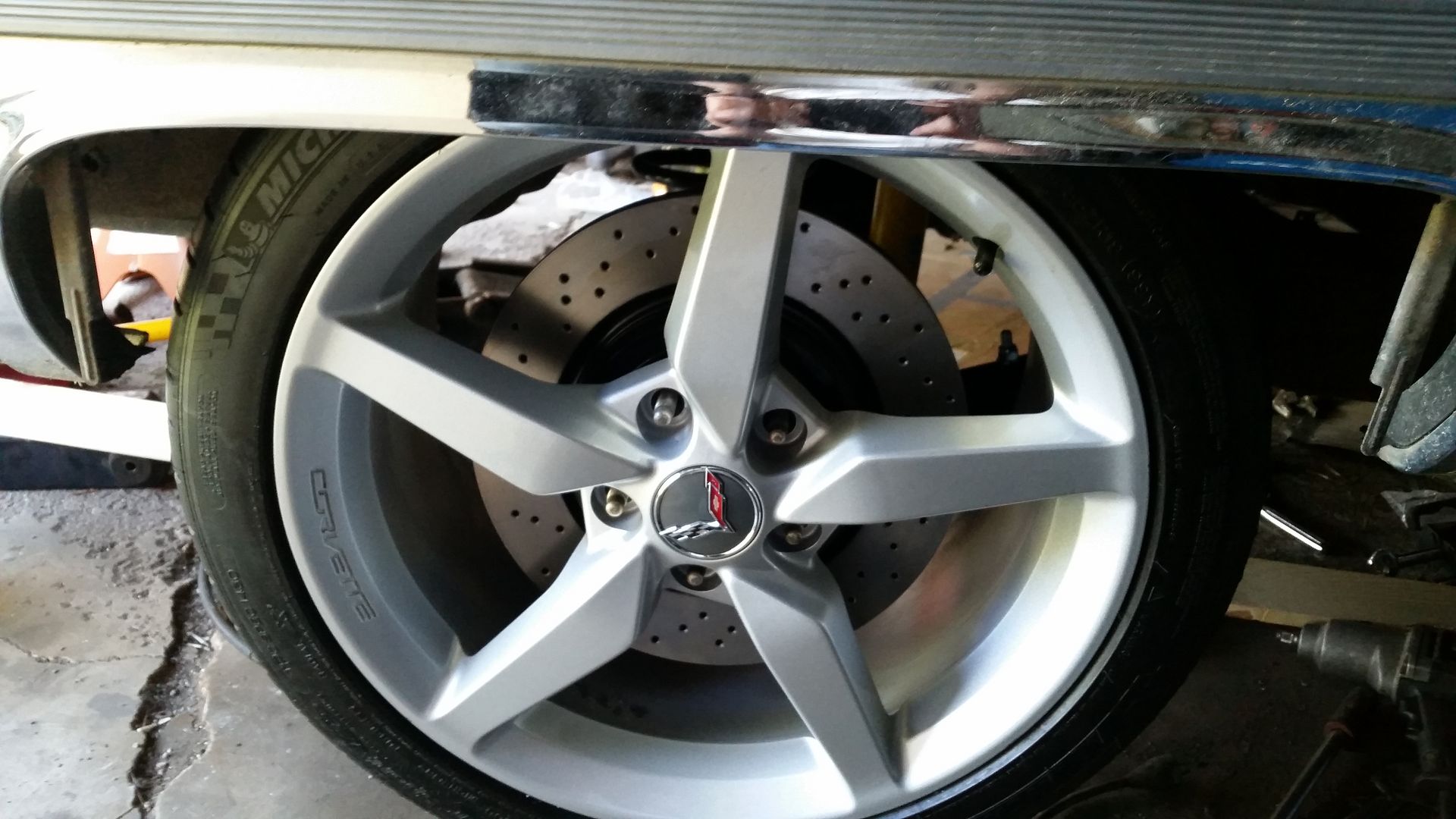

I was getting the axle flanges turned down for the c7 wheels, and one of them was bent. Sent the housing back to moser to get extended so I don't have to run spacers, and new axles made.

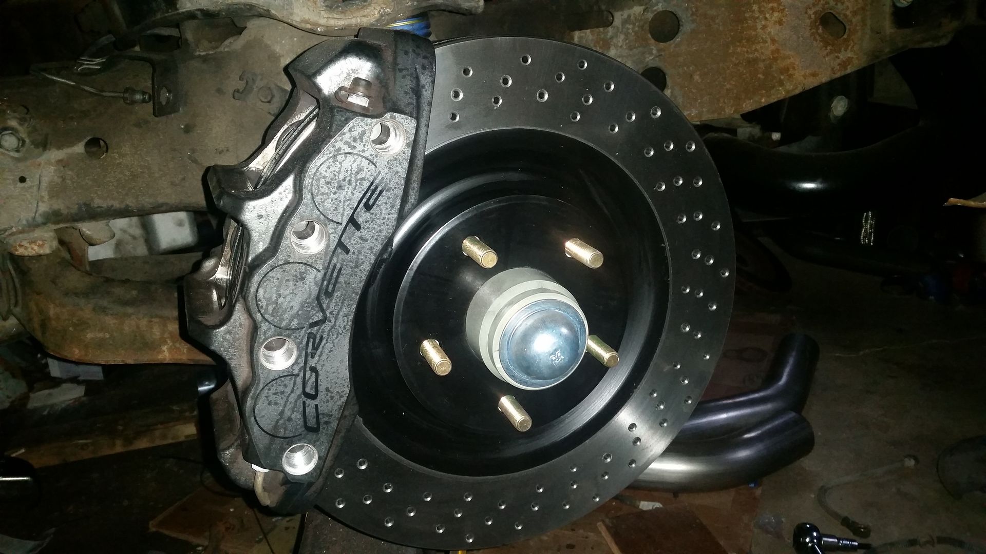

C6Z brakes are done with abs delete, new impala ss master, and wilwood prop valve. C6Z front seats, umi extended rear control arms.
..., umi extended rear control arms.
Why extended on a FW? Skirt clearance is the only thing comes to mind unless it's because of the Ford rear.
