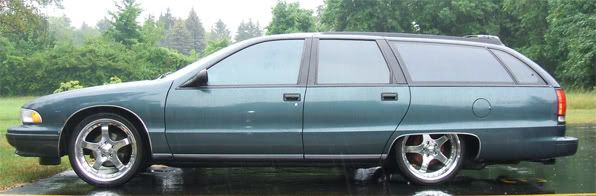

Hello, The rear seems to sit nice and low, but the front don't seem to sit much lower at all.
Is there away, spring compressors or something to lower the front an inch or so?? Or does this seem right to you?

I do know about Intrax sagging in the rear, but the thing is the front dont really seem lower at all from stock.
I'm afraid If I bag the rear, or get differnt springs in the rear it will sit the same as it did before. Then whats the point? Augh?!? Always something?!?
