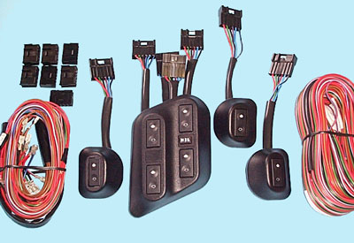

If i cant find a donor car at the junk yard for the harness i was thinking of usung this wiring kit from a1electric.com
i have see that kit in person and on a truck its tacky looking and cheap ....find a donor car..
