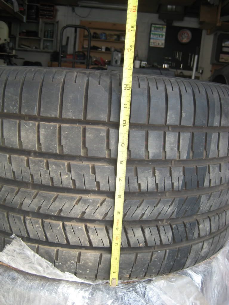

So after scouring the C6 forums, I located a set of wheels, chrome, from an 09 Z06, 18X9.5 in the front and 19X12 in the rear. After talking with the gentleman selling them, he wanted to part with the Goodyear supercar tires as well, with 900 miles on them. I got them at a steal.

Rear tire size

The rears are 67 pounds each, they were shipped with the tires on and nothing but bubble wrap. Fronts were 62 pounds, the lugs and locks were included with the deal, so maybe a pound there.
