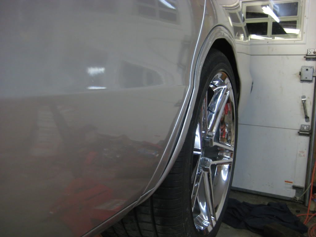

Here is the rear wheel mocked up with the 3 inch spacer, you will see that there is plenty of room from frame to tire, I am going to cut 1/2 inch off the spacer to start, if I don't like how it sits in the fender I will notch the frame and bring it under further. I was pretty afraid as I didn't know if I would like them or not, but I think that they are going to come out pretty good.
Picture is deceiving but there is about 3/4 of inch of space in there.
How it hangs out right now
rear view

I still think you can get em under without notching... but I absolutely understand the desire for more clearance. BTW, go ahead and mock up the other side, you likely find them measurements different, unless you have centered your frame.
Thanks Wood, yeah I am sure that I can, but I would rather have them tucked under a smidge more, I looked at the 20X12 thread on here and if I cut 1/2 inch out of the spacer the wheel would look just like his in the well, leaving only 1/4 of lee way between the tire and the frame. Also if you look at his thread the outside of the rim is CLOSE to the fender. I could get away with this, but there would be no room for anything. Which you understand. Wouldn't take much to notch out to make it happen. As far as the frame and the rear it is perfectly centered, believe it or not, I fixed that a while back :)

Oh, and I strongly recommend you notch. You will eventually rub the frame even if you are running urethane CA bushings. There are 3 kinds of guys that run this wide with no notch.
1) guys that rub the frame eventually
2) guys that rub the wheelhouse eventually
3) guys that won't admit it, or have not not looked to see how much they rubbed.

Well I went out tonight and pulled the spacer off and I wanted to put the wheel up there with it butted up against the frame, now I am going to say this, I don't know how in the hell anyone fits a 12 inch rim without notching the frame, yes I have seen the pictures , but there has got to be something that isn't being said, i.e. oh forgot to mention we had to yank the hell out of the fender well to give me a finger width of distance. These photos are with the wheel and tire butted flat against the frame.
I did put the other side on just to see and it is the same distance from the frame with the spacer as the other side, so I know that I have the rear aligned in the car. I think that the body is twisted towards the drivers side a bit, so I may have to work on that, but it is damn close.
This picture is with the 3 inch spacer on the passenger side, the pics above are with no spacer and the wheels sitting against the frame.
Well, that IS conclusive.
Yeah Wood, I guess that every car is different and every rim is going to be different, but I guess I am lost at to how a 12 has been fit on our cars without cutting. I don't see how it can be done, an 11 inch rim with 12 inches overall width, but 12 inches with an overall width of 13 on the rim, not including the tire.
I don't know doesn't matter much to me, I was going to notch the frame anyway, well I am going to narrow it ;)
