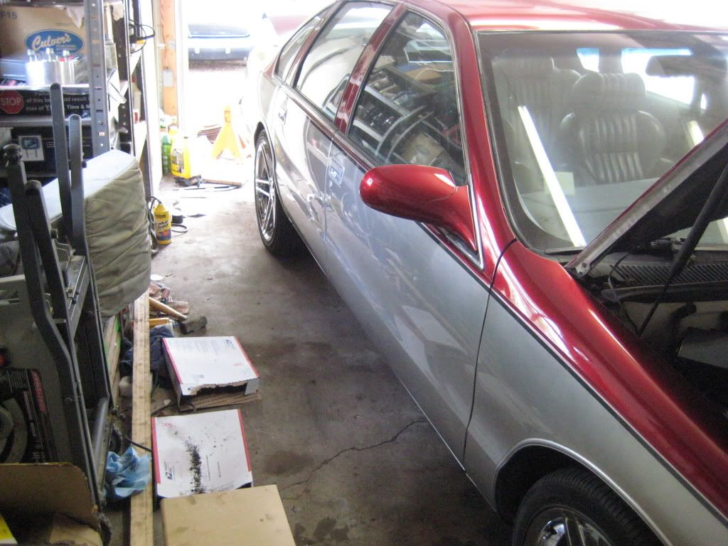

Well here you go, I had to set it on the ground just so you guys could see LOL, well ok I wanted to as well :)
Still need to get the right spacers for the front at least, the rears are close, but I maybe bring them in .2-.3 of an inch, front definitely needs .7 to .8 taken out of them.
Mind the mess, so much going on at once, my shop is a pig sty, but oh well. I will shoot more when I get it outside and stuff, but it isn't running at the moment and I think that I have to bleed the brakes one more time, there is a little moosh is the pedal still, I will get it, parking brakes work like a champ. :)
There you go more later.
Looks good Mike!
Roger
Thanks man I will have to get some pics of it outside, but these will do for now, I still have to do stuff underneath of it, but couldn't wait :)
Tough man. I'd still like to see it lowered another inch or so, just to tighten it up and bring her full tilt. Hell, you're doing everything else maximum, but that's just me. And those breaks! Must work and feel "special" and look 10x better in person. Please keep us posted. Fun to see your work. You must have an even bigger small fortune in tools than I do.
Thanks man, I am going to let it settle for a day or two and see where it rides out at, The springs that I have on it are hotchkis and I am not going to cut them up or anything, worst case I have to get another set later on down the line. But I love the way the car rides and handles with them. I think that the rear needs to come down another inch and the front should be alright. I will do some testing with some spring clamps and what not yo see if I can find the sweet spot for the rear. The front I just put in the ZQ8 bumpstops, and I trimmed off the recommended 1/4 of an inch, but it is riding pretty heavy on the bumpstop with just a 1/4 of an inch cut out.
