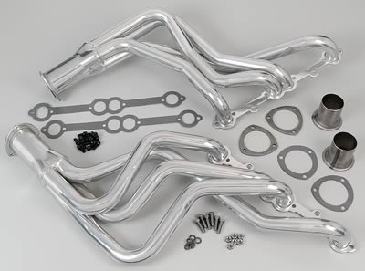

I have had excellent luck with the Flowtech Afterburners. They are a GREAT fitting header. Better than the Tri-y's, even.
Uncoated for $185 http://www.summitracing.com/parts/BIG-49100FLT/
Coated for $335 http://www.summitracing.com/parts/BIG-49100-1FLT/
I also have these in my garage waiting to install. Summit branded dynomax coated headers for $189. They look to require trimming or removing the frame braces, too. But they are CHEAP!
http://www.summitracing.com/parts/SUM-G9001-9/

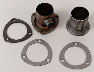

Both can be used with o2 bungs in the collectors. Wires should reach.
http://www.summitracing.com/parts/BIG-10110FLT/ $29
Or you can skip buying the reducers with the o2 bungs. Summit sells bungs for like 4 or 5 bucks a piece and you could just have someone weld them onto the ones that come with the headers to save a few bucks...

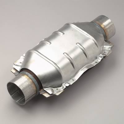

Cats? Walker High Flows for $55 each
http://www.summitracing.com/parts/WLK-15038/

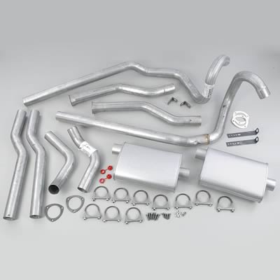

Oh yeah, and for the ULTIMATE cheap exhaust, I ordered this, too...
http://www.summitracing.com/parts/SUM-680131/
$199 now, but was $170 when I ordered it. That's a complete 2.5" exhaust that SHOULD fit. :)
