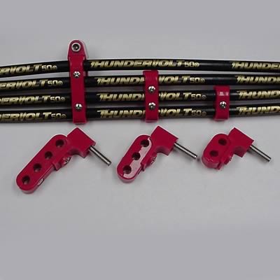

Has anyone installed or had any negatives on these taylor spark plug wiring looms?
http://www.summitracing.com/parts/TAY-42561/
I want to clean up the engine bay somewhat and my plug wires get close to my headers, i have the little plastic holders, but i noticed a wire slipped out and was on the header. they look like they work fine on these F-bodies, but just curious if any of you have used them on your b-bodies
So if anyone has any info on these and how good they work, let me know
Thanks

I installed them the other week. So far no problems.

the pics after link are for the f-body, the link, is was i searched on that site
any pics? what headers are you running?

thanks bro did you have to custom taylor the wires or were they in a entire kit? i just need the looms, but if i have to custom fab the wires i might as well get them too
1,401 Posts
Mine was the whole kit from Thunder Racing.
The opti ends that come with that kit are for an F body but will work on the B body. Just some of the boots end up against the accessory bracket.

Word of caution. That dip stick is on because I broke the original one off, fighting with that #6 plug. What a bitch that was:mad:
Here's a link to a thread about ovc wires.
http://www.impalassforum.com/vBulletin/showthread.php?t=243912&highlight=otv+plug+wires
If you do some home work and searching you might be able to piece together something cheaper.
Next time I'm gonna try this ( http://www.summitracing.com/parts/ACC-170064/ ) opti boot kit. It seems like it has the proper boots to work on a B body.

Hornet,....I have Corvette Composit valve covers. Are you saying those Looms WON'T fit these covers ???
They seemed like they would leak with the lt4 covers. They don't sit flush down against the top because of the way the bolts seal on the lt4 covers.
