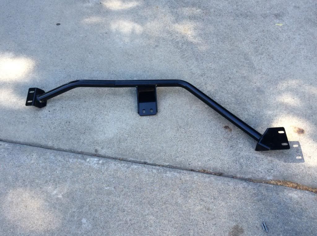

I know it's been a while but I have been accumulating parts for this swap! One of the last pieces of the puzzle came in the mail today direct from bow tie overdrives! Gonna sell my 4l60e with the yank TC and that should buy my clutch!!!

You know Roger, I was concerned about having to clearance the back of my trans for the BTO piece as well, but didn't have to. I bought it between a year to 2 years ago. Even with no shims on the mount. So Narc, just take note of this in the manual, and when you have the trans in place marking for the tunnel hole, put the x-member up there and verify if the extension housing for the rear torque arm bolt (from the f-body needs) needs clearance or not. It will save you possibly one extra install and removal. Your arms and back will thank you.
Thanks for the heads up! Say this BTO unit feels a lot lighter than the stock x-member, any idea what the weight savings is?
