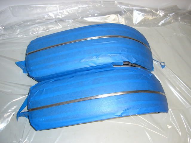

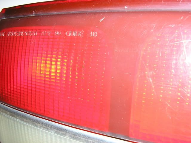

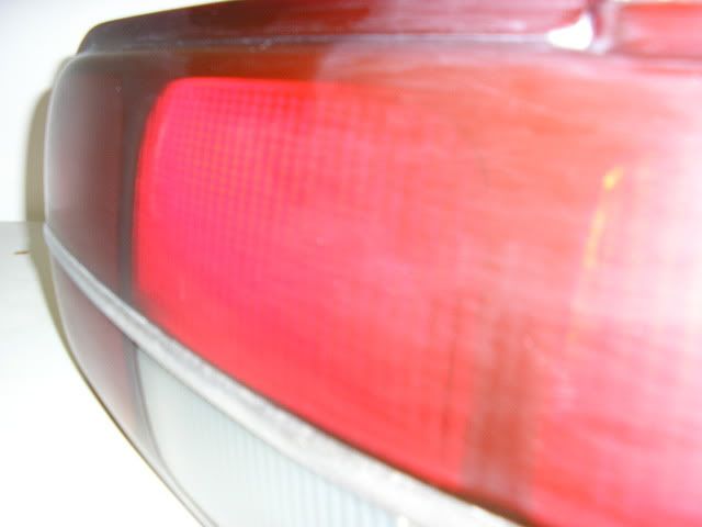

Started off with 800 grit to smooth out the bigger imperfections and sand off the DOT numbers on the lenses. This only took about an hour to do. Then I taped everything off except the chrome strip in the middle. My plan is to plasti dip the strip. Then I will remask the rest tomorrow to spray the VHT Nite Shade, and then follow the rest of Nashs steps. Heres pics of the progress so far.
DOT Numbers
Numbers gone
