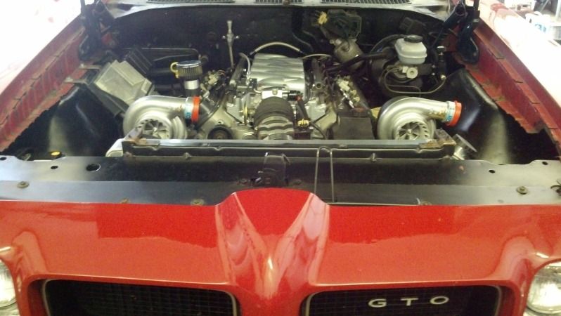

I found a off the shelf on thats looks like I could make work. There more of a high mount design they appear to clear all the accessories. Ac look like it could work with the right pump and custom hoses. It was designed for a ls swap and I been comparing pics with ls swap in our cars. Since I trying to limit my out sourcing these seem like a good Idea I'm not looking for 1000hp just a fun cruiser with a little wow factor. I know my current turbo setup is limited. So this should keep me happy for awhile.

That looks like a pretty slick setup that should fit our cars pretty well. What brand are those? I'm not familiar with them.
874 Posts
They are those cxracing brands I been reading up and seems like there products are getting better. There designed for a supra ls swap and even claim to have been fitted in a gto. I figured since it's a one off setup I would have to do sum relocating of sum other things but it would also clean up engine bay. It look like even the down pipe design could work also. Drivers side might require oval piping by steering shaft but that's no biggie. They sell a whole kit with turbos manifold and wastegates for cheaper than what I was quoted just to do a manifold. I know there turbos aren't the best but for startup and getting a base idea of what I'm doing. I think it could easily push 650-700hp considering most ls will give u a base around 400hp. When you check it out ans see price you will probably buy. Im just holding off until I can figure out when to bring my car to me.
