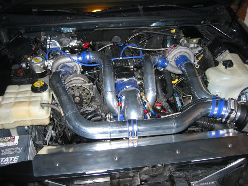

Guy who have ran a twin turbo setup what size downpipes did you run? I recently acquired twin system and im thinking its a mease system. It has a 2 1/2 down pipes off each turbo. Will those flow enough to support a 600hp build? I will be upgrading turbos but wondering what others have used. Also will a 3 inch exhaust be needed or will a good flowing 2 1/2 work? Thanks for your help once i get further into build i will start posting more pics
