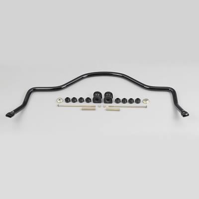

For anyone that is looking for a new one you can buy the larger 1" Addco aftermarket kit (#650) for the Crown Vic for about $177 on ebay. I think Toomanytoyz put the Addco Crown Vic bar on his wagon. He might be able to chime in on its performance.
