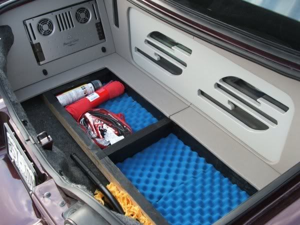

For a simple set up like you want here is what i would do.
Get an Alpine PDx-5 5 channel amp. It is small and can be placed behind a side panel.
I would build a sub box on the the other side panel and put in a shallow mount sub. Kicker CVT or a pioneer sub come to mind. Build hinge covers and leave the spare in the stock location. If built right it will look very nice and sound descent.

I'd do whatever ^^^^ says.
Wait, I did...cwm4

Thanks man. I see the light LOL
