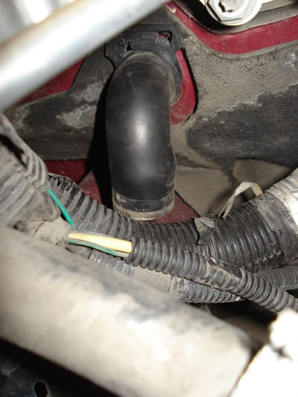

HuSSker's Poor Man's A/C Drip Elbow
Here is a fix I did on the B4U:
You might recognize the part commonly used here:
+1 that it is needed. From under my car I saw that without the drip elbow, rust had developed pretty bad where the firewall meets the floorpan, below where the water ran down the firewall. If it just dripped instead of being blown back into the car or down the firewall, it went directly onto the ABS sensor connector on the frame! (ABS connector should be tough, but that can't be good for it!) I extended a line from my drip elbow all the way below the pass. door, to make it easier to detect a blown heater core.

After you fix that, I recommend you attach some sort of elbow to the nipple and a hose to direct the A/C condensate below the car. I used a 90°spark plug wire elbow and a piece of clear plastic tubing with some zip ties.
