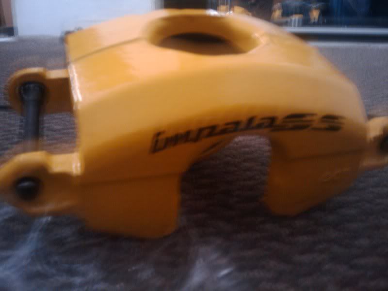

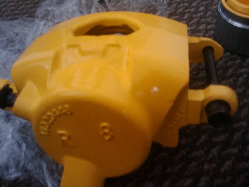

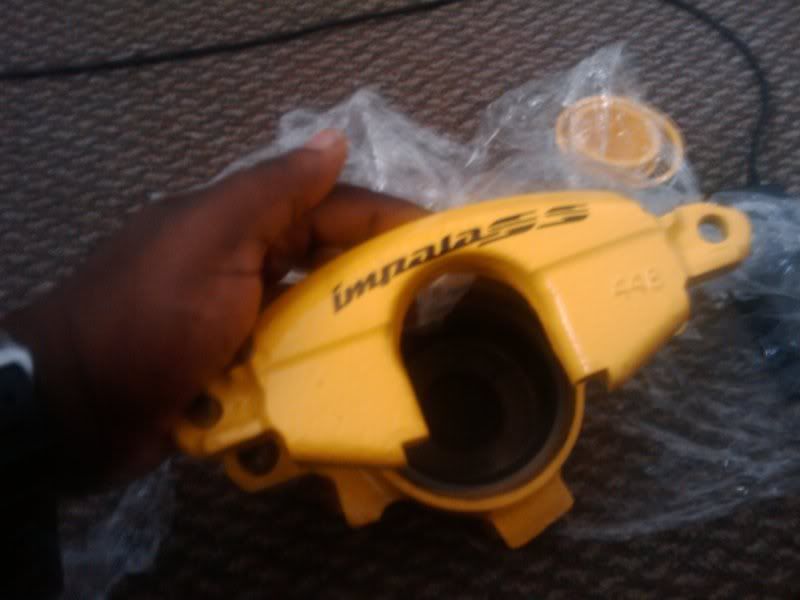

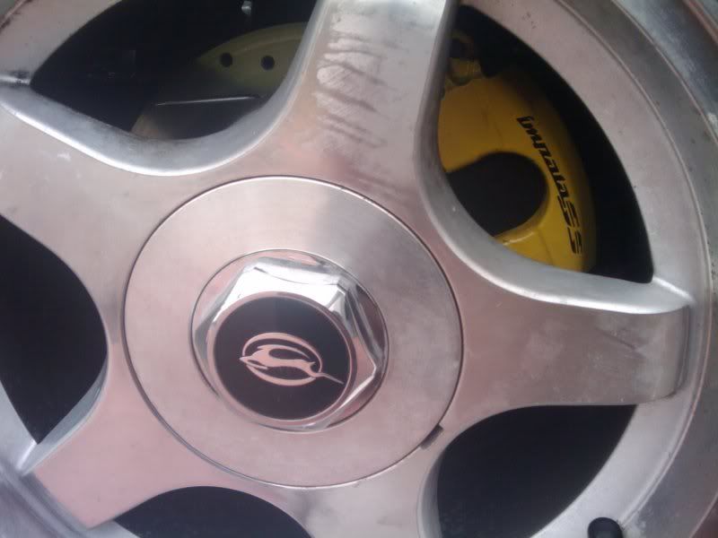

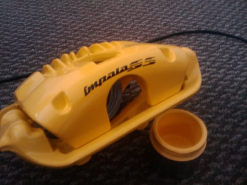

had no problem with my rebuild
i rebuilt all four of my brake calipers and had no problem. then powder coated them yellow. i got all my parts from rock auto
Look like new

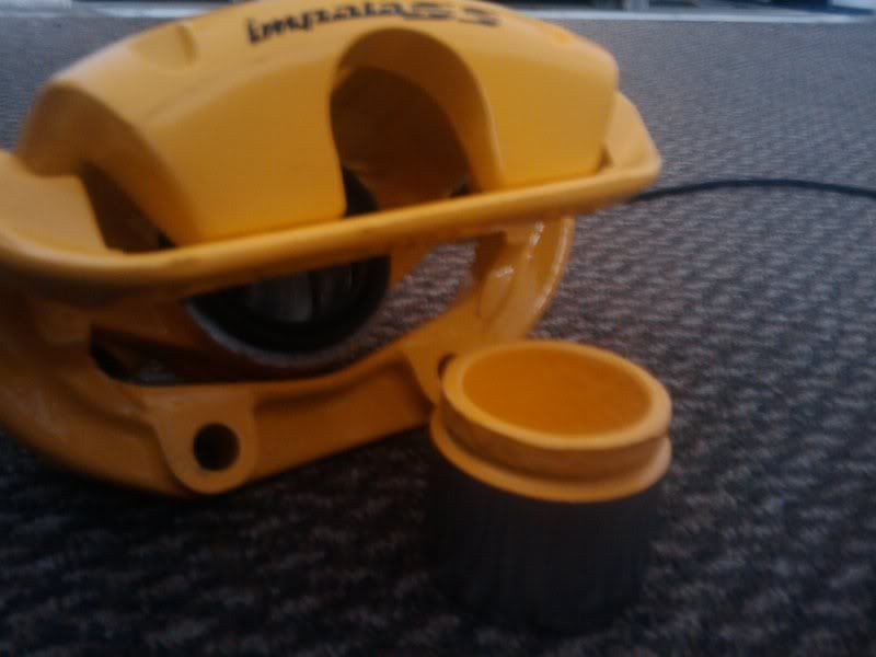

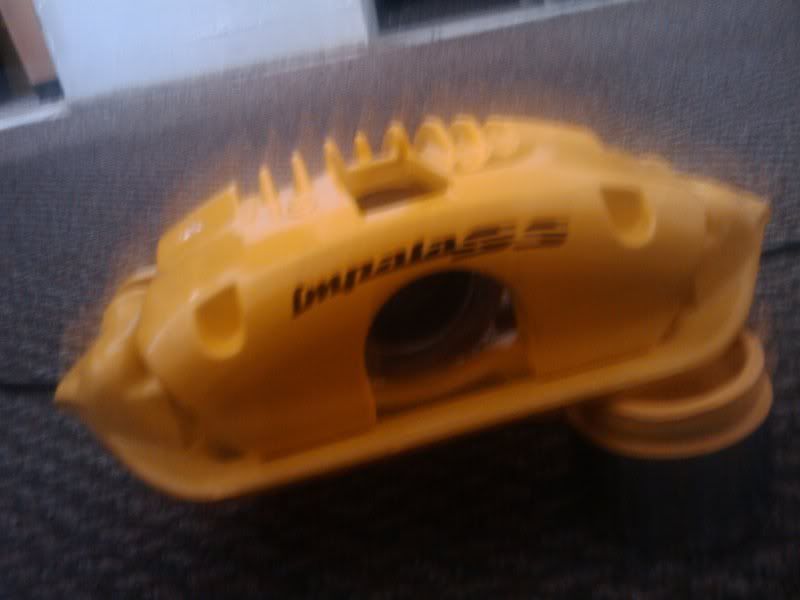

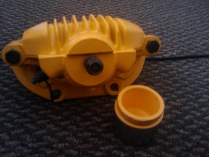

are your rear calipers finned like the yellow ones?
I recall seeing pics of different B bodies with finned and non-finned rear calipers, maybe they use different kits.

both mine and the set i got from the junkyard are finned
