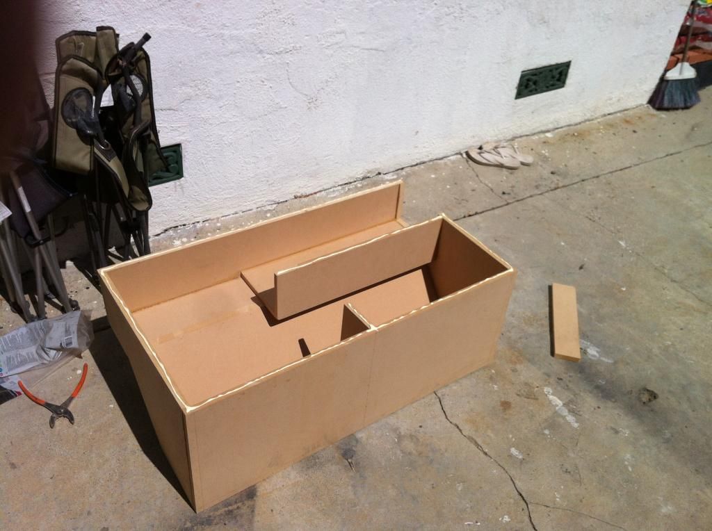

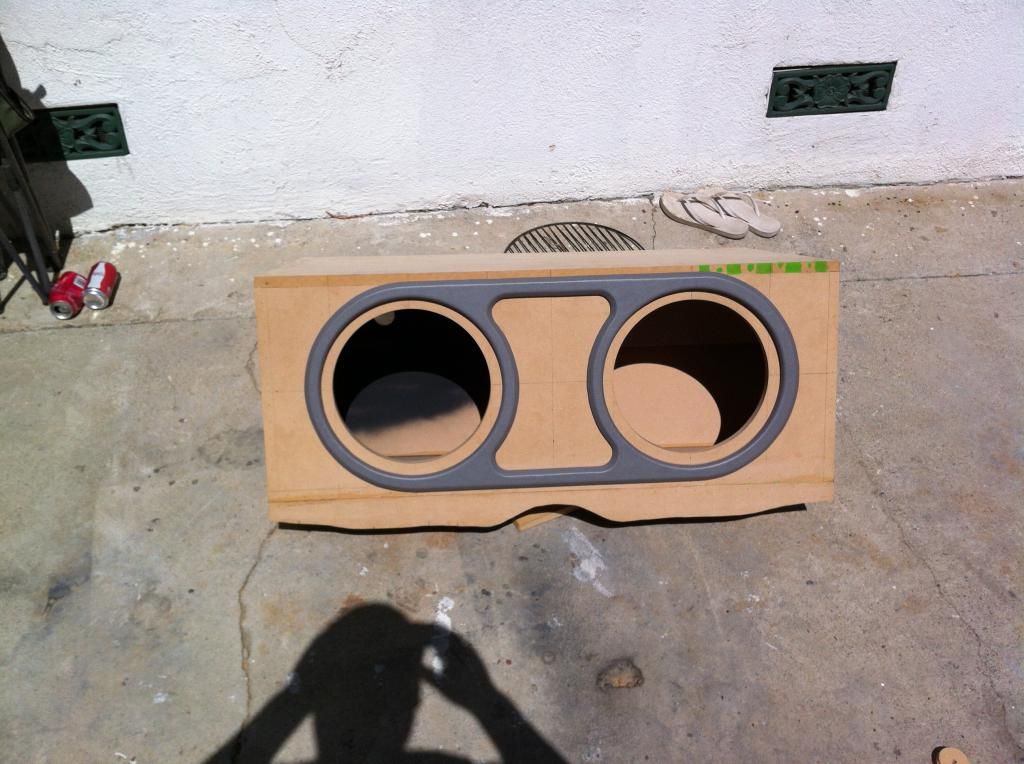

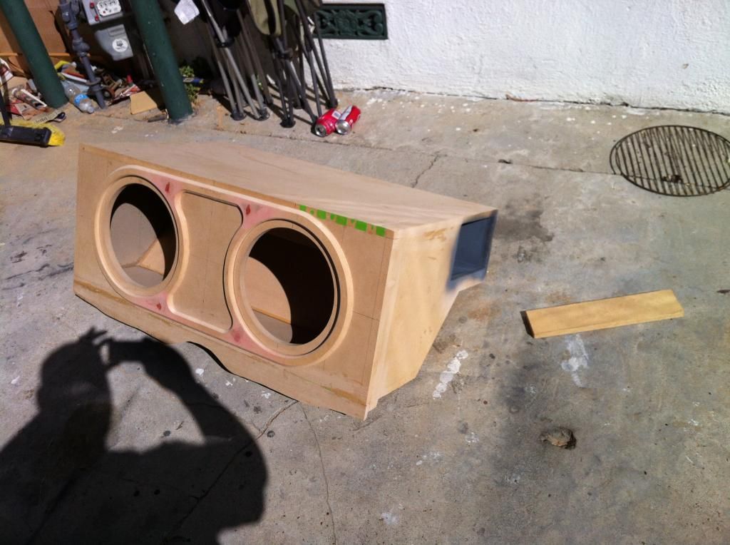

Here's a few pics of the box I built for the wcg raffle.
Side firing port.
Trim panel wrapped in grey vinyl.
I'll post the finished pics in a bit.

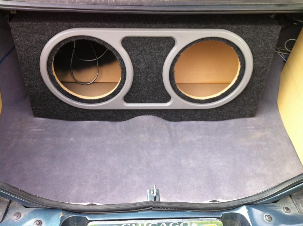

Box is done. Here is what it will look like in the trunk of a bbody. Box is 3.6 cubes tuned to 33hz.

It looks good buddy! And we definitely appreciate your sponsorship and support of the show!!
