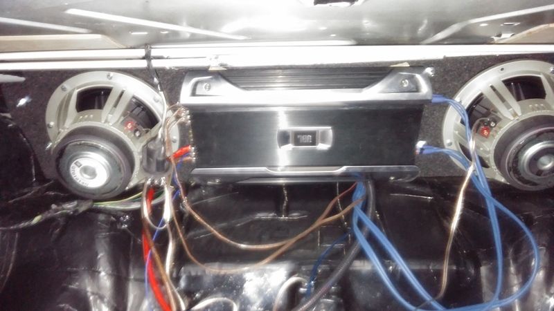

6.5 inch SUBwoofer? I am curious how well those performed pre-death. I managed to squeeze 2 - 10's in an infinite baffle type set up. That fit entirely under the rear package tray against the backseats. Although I eliminated the rear deck speakers in doing so. I ran a four channel amp and powered the fronts off 2 channels and each sub got their own channel. I was not feeding the subs their max RMS and the whole system still sounded GREAT when combined with sound deadener.
Wires were messy in this pic
