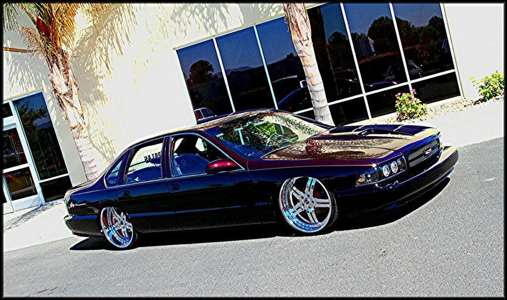

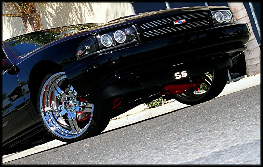

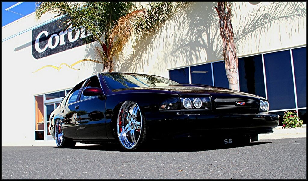

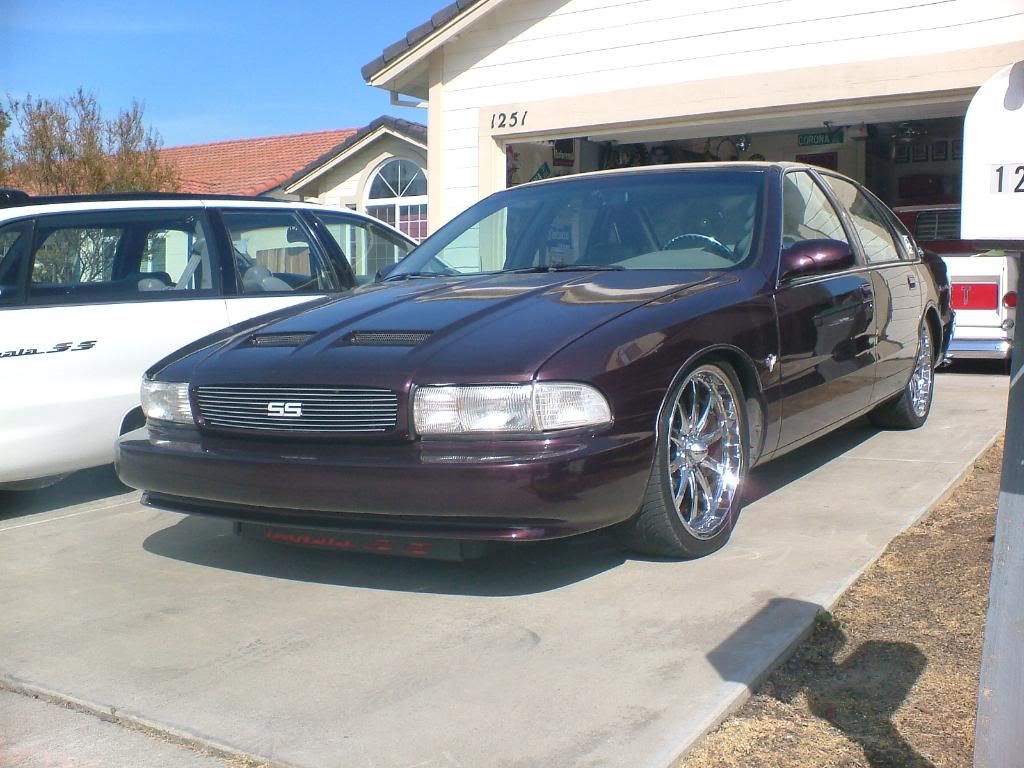

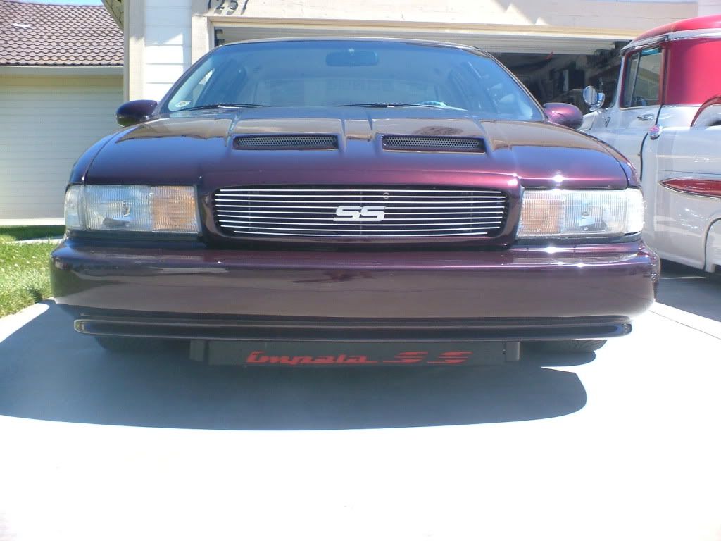

here are some pics before i tore her apart...96SS DCM ..bought it in back in 2000
there was alot more to it.. but... i got bored.. lol

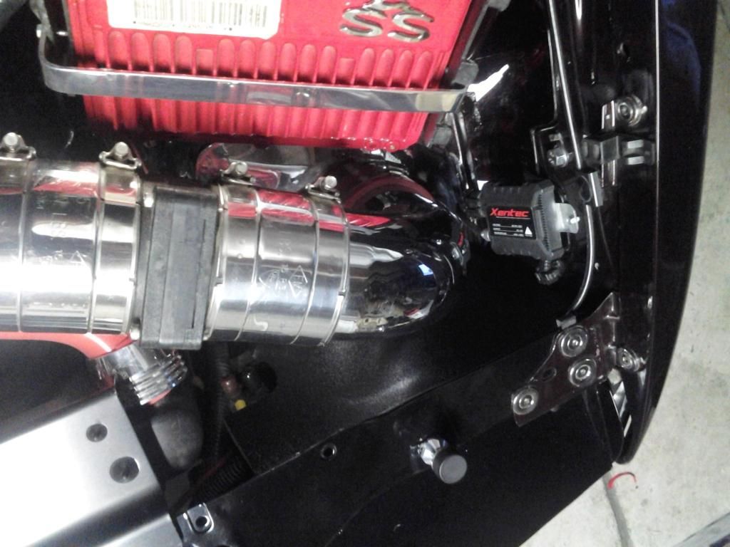

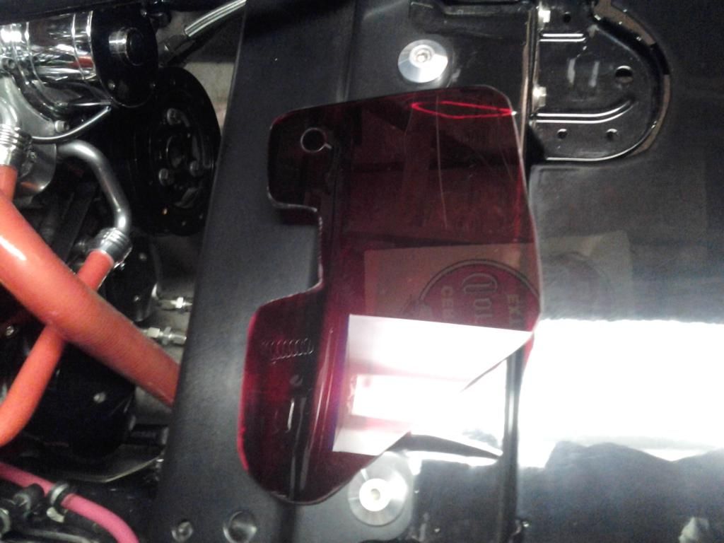

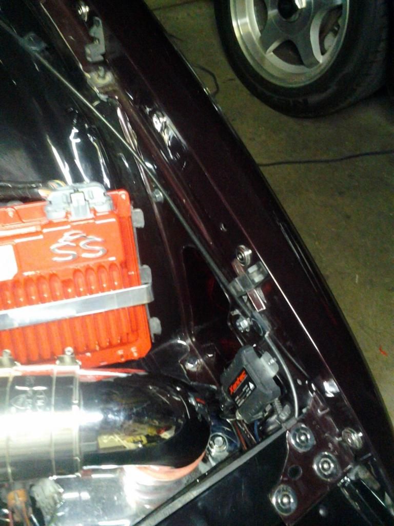

what is that right in front of master cylinder.
Reply With Quote
  #3
Old 05-12-2011, 09:29 PM
mrbbody's Avatar
mrbbody mrbbody is offline
Join Date: Feb 2009
Location: Cen Coast Cal
Posts: 1,833
mrbbody is on a distinguished road
Default
oh that was an alarm horn ,no longer there

Alarm siren.

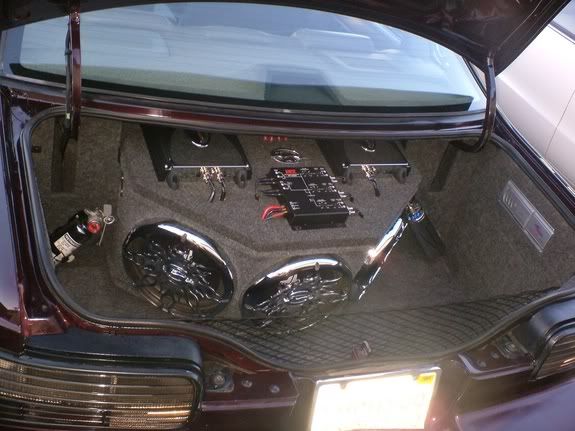

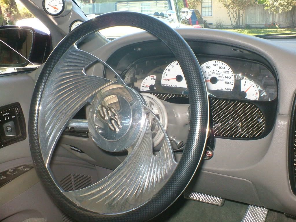

ill start with the interior.. wont bother with the how to's
wanted to do a throw back theme so i morphed in some old school things ..
not finished yet, may change some things around. but you get the general idea
gonna throw in a double din for the hell of it
making sure it fits before paint

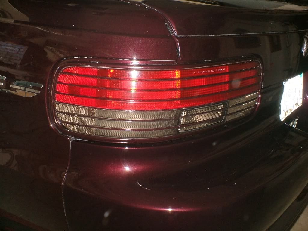

I Remember the first time I saw pics
of this DCM on cardomain.
And im SURE this ONE IS yours hahaha.
Anyways, I Love how you did the door panels.
That and the Retro Tails you did for this car....
Made me get my "sticky rice" all on my screen

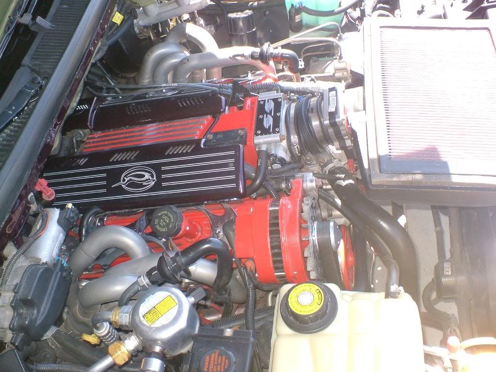

now for the motor. didnt want to go too crazy cuz money is an issue...
F body heads ported, 7/16 studs and guide plates installed. 3 angle valve job, beehive springs. heads surfaced at a slight angle for compession.
intake matched ported, new rings and bearings, timing chain, gaskets and seals. LT4 hot cam. 1.6 roller rockers, new lifters and push rods, water pump drive delete ,clear image cats, try ys coated..still need to get throtle body and electric water pump. will attatch to stage 2 trans with 2500 stall then inland impire axtended aluminum drive shaft... more to come....old motor out
block, heads, intake,timing cover, water pump, assesorie bracket, oil pan, and valve covers powder coated
