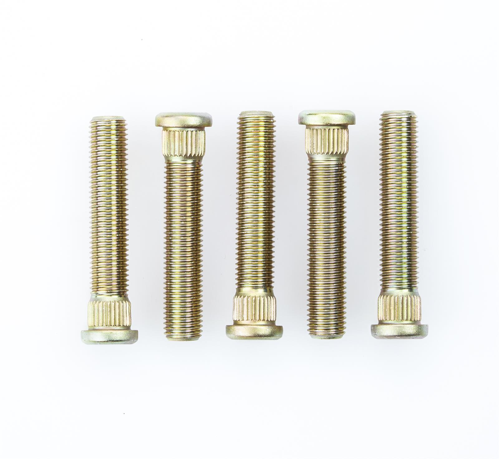

- ARP 2.5" studs

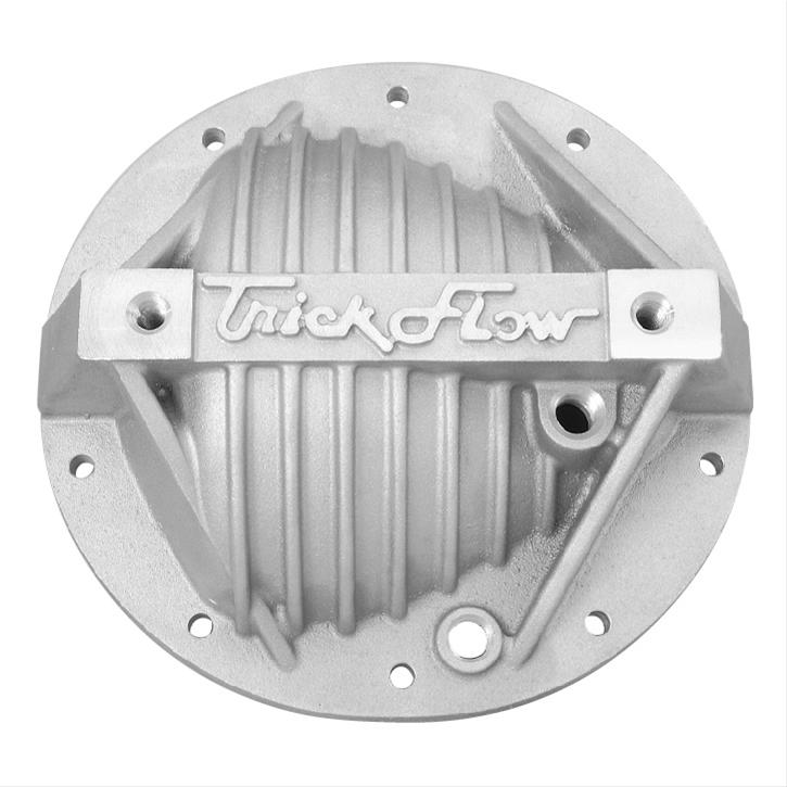

- Trickflow HD differential cover

ARP Wheel Studs -
TrickFlow Differentia Cover -
