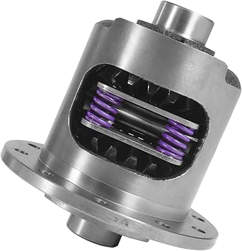

The Yukon Duragrip is currently the best deal you will find on a posi, which is $300 brand new.
For the 4.10 gears, I recommend Quick Performance, as they only charge $99.
For the record, this is the "super budget" option:
Go to the junkyard and go to the section where they have the Trailblazers and Envoys. They all came with either 3.42, 3.73, or 4.10 gears, and most of them came with a posi. Just walk around and check the option codes until you find one that has 4.10 gears and posi. Bingo.
I recommend Edge torque converters, as they are solid and affordable. It's about $400 for their 2600 stall converter, and you get lifetime re-cuts for $50 (basically a "rebuild").
