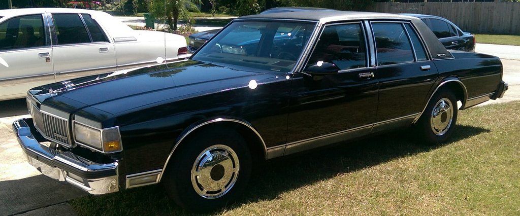

Added another B-body to the stable.
1987 Caprice Brougham.
The Good:
- One owner 85k, garaged, Florida-only
- 0% rust, anywhere (Needs filler panels, body perfect otherwise)
- Maroon velour gut, like new
The Bad:
- Computer controlled Quadrajet on a 305, with a spaghetti-mess of rotted-emission lines
- 200-4R metric trans
- 7.5inch one-legger w/2.56 gears
I would've been ok with the stock 305 if it were in good shape. This one isn't.
I have a 94 9C1 beater with a spun rod bearing (i suspect). I haven't torn-down the motor yet, but it has a fresh trans and a freshly built rear. I'd do a body-swap, but the 9c1 frame is pretty rough, and the 87's is perfect.
Do I invest money in rebuilding the LT1 of unknown condition, since all the other components are a direct swap-over (fuel-tank, lines, rear, drive shaft, etc) or am I money ahead to attempt a 5.3 swap (which entails more customization) ?
