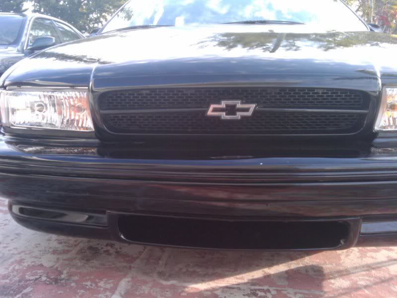

I have a question about our stock front bumpers?
i know our bumpers are urethene plastic right?
if i fiber glass my entire bumper and will the fiber glass stick to it?
i want to make my front bumper lip spoiler and bumper one piece
see pic
so any advice will help because i like the look of our stock bumper and do not want to buy the smooth fiber glass ones. i know u can make the smooth bumper and lower lip one piece but dont wanna get rid of the stock look

my bumper is not from street trends. my bumper is a stock bumper with a lower lip attachment i bought off ebay and i attached it to my stock buumper if u look closly with screws and i cut the middle of the bumper to fit the lip attachment
see take a closer look
stock bumper with fiber glass lip attachment
see the caprice bumper before it was painted black
you see its two pieces
now i wanna fiber glass the lower fiber glass scoop to the stock upper bumper to make it all one piece

the chin spoiler is not from street trends a guy on ebay use to make them but does not anymore i bought the very last one

Can it work? Yea maybe? I STRONGLY wouldn't recommend it. It will probably crack after a few weeks. Nothing sticks to those bumper covers well. I use this http://www.lord.com/Products-And-Solutions/Adhesives/Automotive-Repair-Adhesives/Product.xml/314 product for things like that. If your asking this question I'd say you probably lack the necessary skills to do the job (on a professional level). I'll be more than happy to walk you through it if you attempt this on your own. I'm here to help

no fiberglass will hold up on urethane very long or any plastic for that matter.. U should try the Duramix bumper repair tubes, there are a few they offer. It is a two part mix, but like Nash said, it will take some prep n skill to pull off well.. Never used it myself but learned about it while redoing my car. The gun is what u need to find and borrow. I think it is like 35 bux itself. HTH, Peeeeez out
