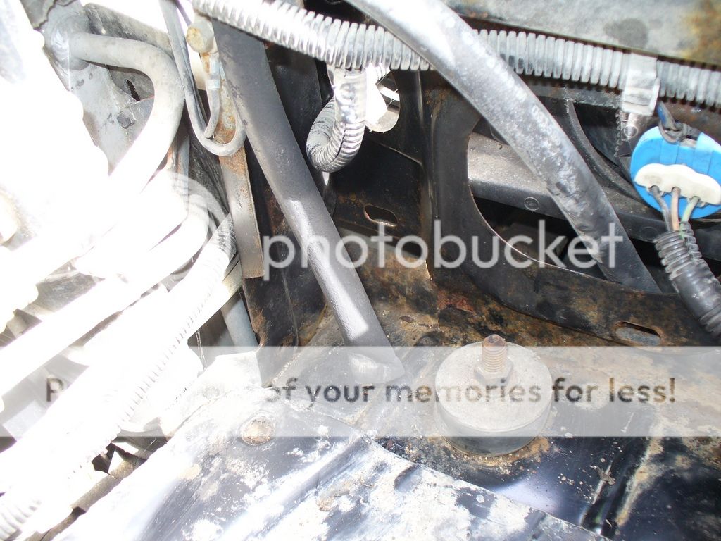

Where is this supposed to go?
It's coming off a tee between the battery and the headlight.
Wait....don't tell me, gas tank? :(

There's a hose that's supposed to be open (going to nothing),and that could be it. Looks like somehow it got pinched shut over time.

It could be the the vapor canister hose as described in this thread starting around post7.....
http://www.impalassforum.com/vBulletin/showthread.php?t=345905&highlight=Evap+hose
The cars I've seen have it in the fender well area. Some have described this also being in the battery compartment area. Maybe yours was crimped or sandwiched between the inner fender and battery tray somehow? If you trace the hose back and it goes to the charcoal canister then you found the right hose.
The diagram in the link shows how these hoses are all connected. Good idea to replace them if they are original.....beware - they will be a sooty mess. :(
Semi-permeable fuel hose for the EVAP canister vapor evacuation. It degrades into black dust w time. There's been enough time. Replace it w/ like hose. If there are leaks or degradation of the hose, vacuum related issues arise and the EVAP canister purge solenoid can become clogged w/ the hose dust.

canister vent hose is what that is. I replaced all my fuel tank venting hoses behind the bumper last year. make sure you use gloves because that rubber is like black glue very hard to get off your skin...the hoses get so soft they get pinched and block flow of tank venting thru canister.
being hidden you don't see it all.. problem I had was too much fuel tank pressure.... after hose replacing ALL at the canister no more high pressure with fuel tank cap removal.
with the hoses breaking down sure can block the purge valve..so replace that hose also..

Went out and had another look.
It seems the other part of the t is not connected either.
So these just vent to atmosphere I guess?
Here is the pic from the other thread.
These would correspond to part 5 and 6.
#7 ·
That is correct, if you look at the picture of mine in the other thread, you will see the tee with 2 sections of hose that go to atmosphere. Part number 5 is just showing the hose(s) that are used. While part number 6 is the plastic tee that connects them.
I think laying in the fender is best for this hose as its away from things and can't possibly be damaged like how yours was. You can see how that is from the pics I posted. Don't have any info or pics of how exactly it lays in the battery area/behind the headlight.
If you decide to do anything with the charcoal canister, it is behind the right front bumper and mounted to the side of the frame. You just need to remove the plastic fender extension (right air dam corner mounts to this) to get full access to it and the hoses. Iirc - there are just 1 or 2 10mm bolts that mount the canister bracket to the frame.
